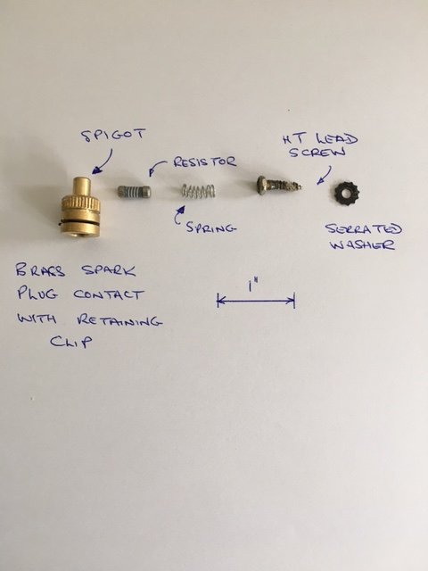

I recently decided to replace the spark plug caps on my E-Type 4.2 SII FHC and opted for the WCX 600 cap. I spoke to a reputable ignition parts supplier and before ordering I enquired about the current quality of WCX 600 caps as it is known that there have been issues in the past. I was reassured that no problems have been reported recently and on the strength of this I placed my order. On receipt, I considered it wise to check the resistance of each cap and, disappointingly, one was found to be open-circuit. The supplier promptly organized a replacement and as they did not want the defective cap returned I decided to undertake some investigations.
The current incarnation of the WCX 600 consists of a one-piece phenolic resin moulding having a main body which fits over the spark plug insulator and a side-arm into which the HT lead passes. The internals consist of a brass insert which locates onto the spark plug terminal, a resistor, a coil spring, a screw with flat head and a serrated steel washer. The brass insert has splines machined into the upper land, the purpose of which is to secure it firmly into the resin body when pressed home. The insert has a spigot which extends from the top surface and fits into a round hole in the upper part of the resin body. A spring clip fits into a annular groove machined in the insert and this grips the spark plug terminal. A hole extends along the side arm of the body and breaks into the hole in the top of the main cap occupied by the spigot. The resistor, which appears to be of the surface-mount metal film type, is pushed down the hole in the side arm and one end cap of the cartridge makes contact with the spigot. The spring presses the resistor against the spigot and is held in compression by contact with the screw head; the screw is locked in place in the side arm by the serrated washer which passes over the threads and is pressed into a shoulder. There appears to be evidence of adhesive which is used to bond the washer in place.
Once I had cut the internals out of the resin body, the resistor was found to have a value of 9.9k ohms and therefore OK. Furthermore, there was no evidence of corrosion along the electrical path which could explain the open circuit. On closer examination I noticed that the resistor was binding in the hole and the spring force was insufficient to press it into contact with the spigot of the brass terminal. Hence the defect was not failure of the resistor or corrosion but insufficient clearance within the hole in the side arm for the assembly to function as intended. Thought you might be interested.
