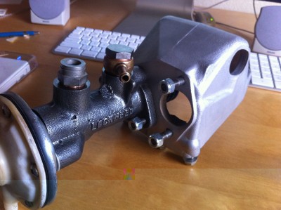

Hello,
I'm restoring my pedal box, but don't know what comes between the cylinder's and the box itself?
Is it just bolt on metal to metal or has there be a gasket or something else between them?
Thanks and regards
Pedalbox

Hello De Waanzinnige,
although not having specific E Type experience, my general experience with a variety of cars, none have had a gasket in that position, the cylinder being bolted up metal to metal.
If you are doing a concours rebuild or indeed just to a high standard there is some merit in using a dense fibre gasket as this would, I think, help preserve the paintwork. Generally when cylinders are removed the paint usually comes with it so causing further deterioration and spoils the general appearance.
Alec

Re: Pedalbox
Yes there are gaskets where everything goes thro the bulkhead on all e types. They are readily available from all normal suppliers. IanHello,

Hi Alec and Ian,
Thanks for your reply.
In the first place it wasn't planned to be a high standard rebuild but now in the process I changed my mind.
Contacted some suppliers to order a fibre casket.
Thanks and regards, Marcel de Rooij
