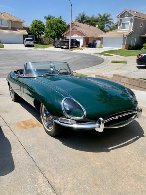

Hi everyone,
I am new to the forum and have a question about my 67 4.2L roadster in BRG with factory the triple carbs .
The other day I started up my car after a few months of sitting. While I was driving At a cold temperature it had some hesitation ( like a short stop) has I was accelerating but after about 10 minutes that stopped when the temperature got warmer It was then was accelerating very smooth . So when I came back home and turn the engine off it made a very loud pop! Like a gun shot.
Any thoughts ?
Thanks in advance
