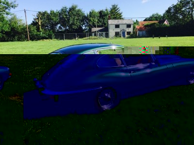

Hi there,
happy owner of a beautifully rebuilt SII FHC, but tyres are a wee bit cracked and elderly. Somewhat like my first wife I believe..... :wink:
Am looking at the options, and although I would like wider tryes for grip and visual appeal, steering wheel wrestling whilst parking (due to the absence of power steering) suggests I follow Longstone Tyres advice. Their website recommends a Michelin, the 180 15 XAS. They are also 'unkeen' on the notably cheaper Vredestein Sprint Classic, which has transformed my MGA.
Would love to hear from those who have gone either 205 or 180 and learn if there has been any notable change to the ride, driving characteristics and steering wheel input forces.
Thanks all and I hope to meet you somewhere this year.
Managed to get a pic in.
Chris C
