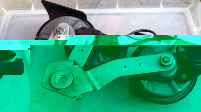

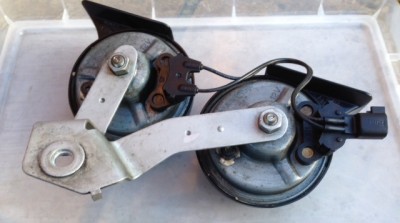

Hi all
Noticed yesterday that the horns on my '05 2.0l diesel were 'missing' a tone. Quick investigation under the bonnet showed the horns to be located on the nearside, one above the other, just under the battery tray. The upper horn connector was accessible and when I removed it there was no sound at all, so my obvious thought was that it must be the lower one that was faulty. I could see from the markings that the lower one was the 'high' note. I telephoned Jaguar main dealer for the price of a new 'high' note horn and after giving VIN no. was informed that the horns come as a complete 'assembly' including new bracket etc at some £63 + VAT - ouch!
Had some time this morning and it wasn't raining so removed lower shield from the car and gained easy access to the horns from underneath. I removed the horn assembly (one bolt) and discovered that the connector I had removed actually feeds both horns so my deduction on which one was not working was not necessarily correct.
By removing the horn wiring harness from both horns and making a measurement of electrical resistance between each pair of horn terminals, both horns were showing the about the same resistance which was a good start. However, closer inspection showed that one of the connectors on the lower horn was slightly corroded. This was cleaned up along with everything else and after reassembly all working well.
Picture of horn assembly removed from car attached.
Hope this is of use, Steve
