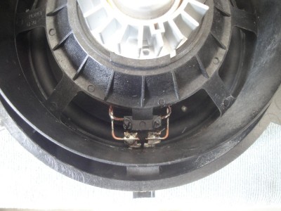

When I first got my current X type, three of the main door speakers were not working. When I checked the outputs from the amplifier, all was well, so I moved on to the speakers themselves, all three of which tested open circuit. However, further investigation showed that they were OK when tested across the flying leads rather than the terminals. Re-soldering was no help so I added a pair of jumpers from the leads to the terminals and all three speakers are now back in service
Photo attached.
The only snag with getting at the speakers is that it seems impossible to remove the door cards without breaking at least some of the clips, so getting a few in before starting is useful. Easily available on Ebay
