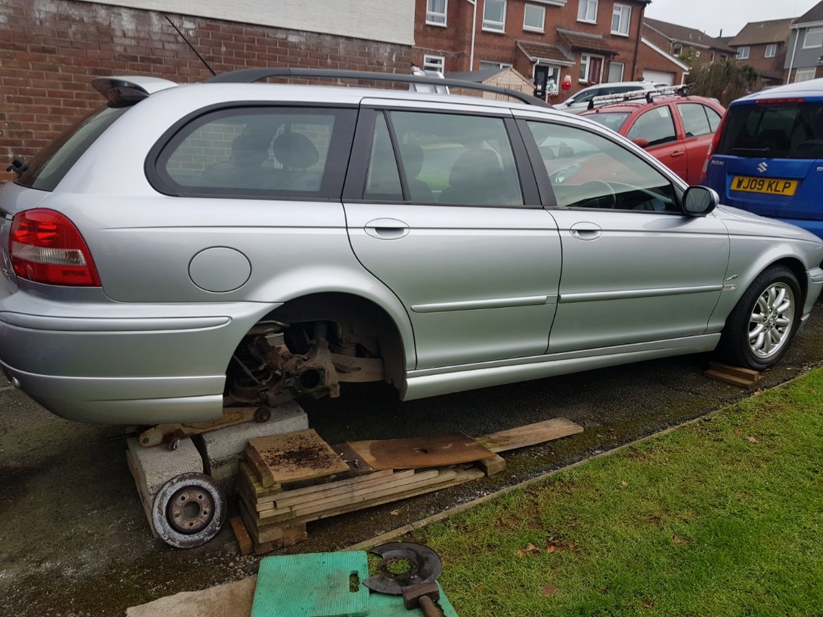

I only have a drive way to work on my cars and that is on a slope but I have made a pair of ramps and once the car is on them it becomes level and is quite easy to get underneath and work on.
Road wheel off,then the brake caliper,mounting bracket and then the brake disc,all came off without any problems.

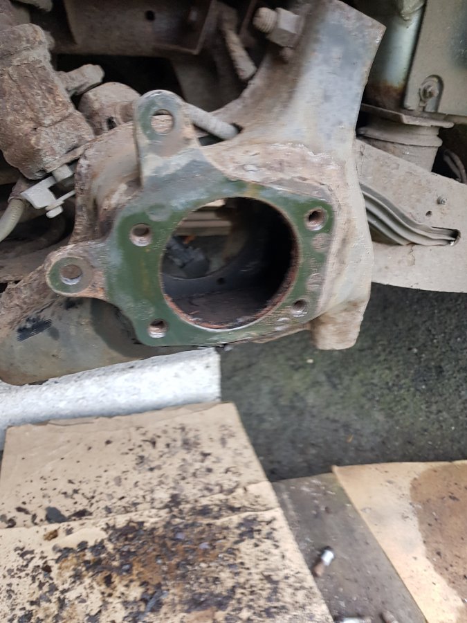

I went underneath the car to unclip the ABS sensor from the rear of the hub and noticed there is quite good access to the protruding bolts through the rear of the wheel knuckle.
Rear Of The Wheel Knuckle
So a good squirt of release agent and a bit of time spent with a small wire brush on the threads.
I also used a impact driver with the T55 bit in it and gave them a couple of quite hefty blows with a hammer before attemping to undo them.
This ensures the T55 bit is seated nicely in the bolt,all this must of paid off,they all came out without a hitch thankfully and those threads were quite rusty.
Hub Removed
A couple of taps with a hammer and the old hub came away.I cleaned up the mating surface and then installed the new rear hub putting copper grease on the new bolt threads.The correct torque for the bolts is 63Nm.
