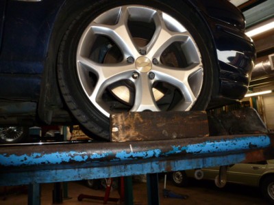

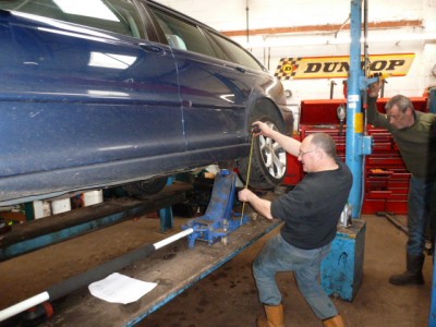

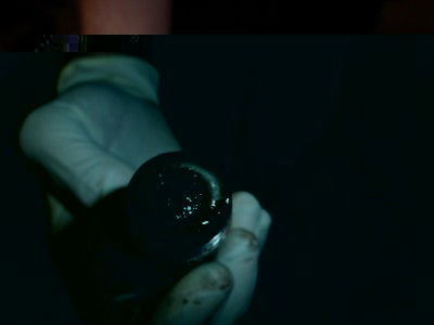

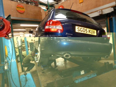

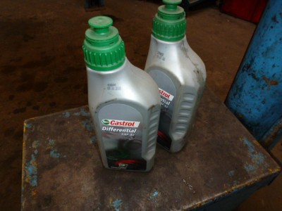

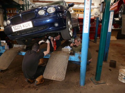

I got Dave Marks to do my last one, four of us on the job, I truth I was surplus to the team so took some pictures
There is a tiny amount of oil in these units, David tells me that all the ones they do, no oil ever come out!!, but the recommended amount always goes back in
so the procedure is to get the car on a ramp, then jack up one side of the car until it a very precise height sill to floor up in the air, around half a meter from memory
then if you are brave from under the car remove the refill/drain plug, and add 650ml (again from memory) of oil , or until it runs out I guess, clean, replace plug, and then with your two assistants gently lower the car back to the level, lower the ramp and test drive
this took 5 minutes to slowly get the oil in, but a good 45 minutes to get the car SAFLY in the right position, David has a specially adapted ramp with safety bars, bolts and chocks to stop the car sliding off sideways
pics are in reverse order due to my incompetence, but you will get the idea
