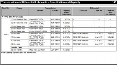

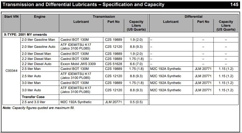

Good point Andy. I missed that the schedule has no mention of the gearbox nor the differential. If not done already I would say change them both in any car at this mileage. Here's the relevant spec page from Jaguar
