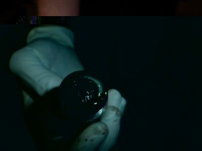

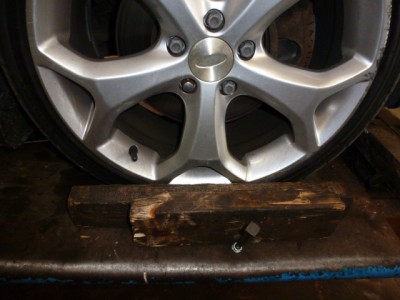

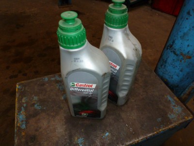

Re: 2.5 X Type estate

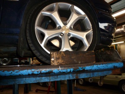

ok here we go with some pictures
the car needs to be chocked front and back
correct oil
manky filler plug

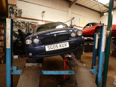

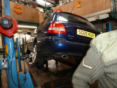

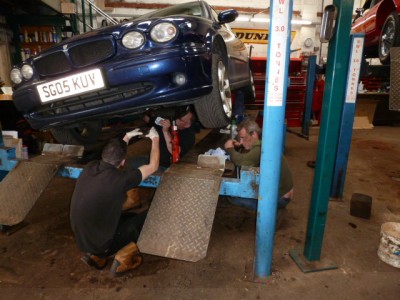

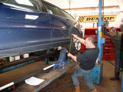

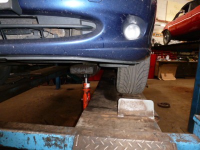

part two
begin to raise the car
check measurements as per Jaguar spec
then drop the ramp leaving the car on a transmission jack to give the required angle
rear view
crawl underneath if you dare and refill until excess oil runs out
job done, drive away, my car was much much quieter after this and has given 30K trouble free miles since, and , I fact when I bought it there was distinct hum, which the friendly vendor told me was a wheel bearing, to date one rear bearing has been changed, but gut feel says it was a noisy transfer box, and the po was told to get rid
