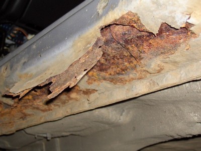

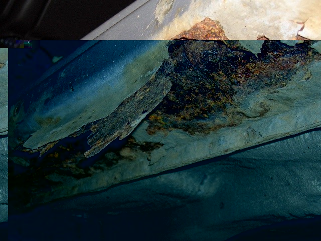

There was some talk about rusting sills on X-types on another board a while back. I think the model in question was a bit earlier than 05/06 but the pictures were pretty frightening.
The full thread is here:
http://www.kelsey-forums.co.uk/cgi-bin/ ... 1313252614

Thanks for this- frightening reading, I hope the latter ones are not the same!

The "Rusty" one in that article really is an early one ( Feb '01 build? ) and I do understand this isn't an uncommon problem on these cars, but it was soon sorted under the continuous development program.
My '03 has had a very hard life, but it's not rusty! I would recommend removing the side skirts though as mine were choc full of debris...
