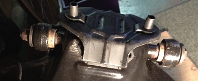

by timedwards
O.K. guys so here is my update. I fitted the genuine mount posted to me by Steve NO PROBLEM at all. I have today purchased another genuine from Stratstones (Jaguar dealer) and again easily fitted! So the only conclusion is that the aftermarket ones are rubbish, with the holes seemingly drilled in randomly. Also I have to say that there is definitely a difference in quality but then they are twice the price. I am no engineer but like I said to the retailer if they have to be contorted to make the holes line up then surely this will shorten their on the car life anyway.
In conclusion, lesson learned by me in that there may be some things that are o.k. aftermarket but with vee mounts I would rather pay the money, have the holes in the right place and not have to re-do the job six months or so down the line.
Here is a pic of the one vee mount in nicely.
N.B. the company however have been very polite and promised me a refund although saying they cannot understand this and never had any complaints before and having received the mounts through the post fitted them onto their frame with no problems. All I can say is they would not go on my frame at all. I am hoping my refund comes through shortly. (It did so happy in the end)
