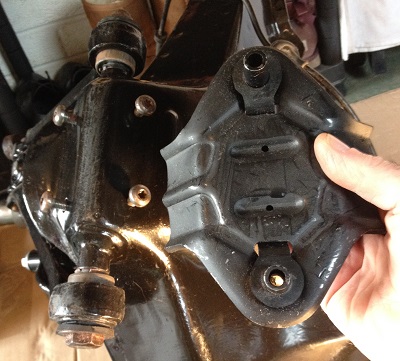

Is it only me or has anybody else had problems fitting new vee mounts to their x300? I bought aftermarket ones (ebay for £29.95) ages ago and just come to fitting after replacing road springs. The holes do not line up so if I bolt the one side down the other side wont quite reach far enough so I can't get the bolts in. Is this a general problem and I am missing a simple solution or have I done a stupid thing to buy aftermarket?
Crossmember was taken off car due to chassis welding and has been painted up but I am sure the paint wont make the difference as on the one side it is short by quite a bit.

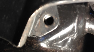

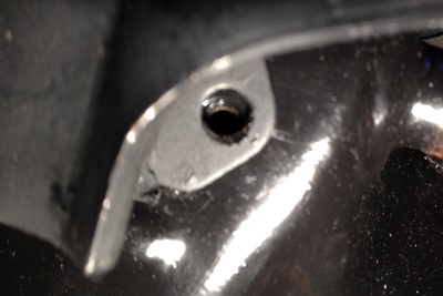

Due to the shape of the mounts I found it very difficult to compare them as you can't hold them on top of each other. However I did take some photos. They are pretty poor quality though.
A little bit out but enough to stop me being able to get the bolts in this side.
Quite a bit out as you can see. N.B. the semicircle mark around the bottom is blue thread locker so it is at the top when looking at the pic where the problem is.
I am still not sure if it may be my error and inexperience of fitting so the jury is out but I am hoping the Jag ones drop sweetly over the holes. I will take pics when I get them.

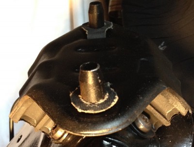

O.K. guys so here is my update. I fitted the genuine mount posted to me by Steve NO PROBLEM at all. I have today purchased another genuine from Stratstones (Jaguar dealer) and again easily fitted! So the only conclusion is that the aftermarket ones are rubbish, with the holes seemingly drilled in randomly. Also I have to say that there is definitely a difference in quality but then they are twice the price. I am no engineer but like I said to the retailer if they have to be contorted to make the holes line up then surely this will shorten their on the car life anyway.
In conclusion, lesson learned by me in that there may be some things that are o.k. aftermarket but with vee mounts I would rather pay the money, have the holes in the right place and not have to re-do the job six months or so down the line.
Here is a pic of the one vee mount in nicely.
N.B. the company however have been very polite and promised me a refund although saying they cannot understand this and never had any complaints before and having received the mounts through the post fitted them onto their frame with no problems. All I can say is they would not go on my frame at all. I am hoping my refund comes through shortly. (It did so happy in the end)
