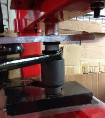

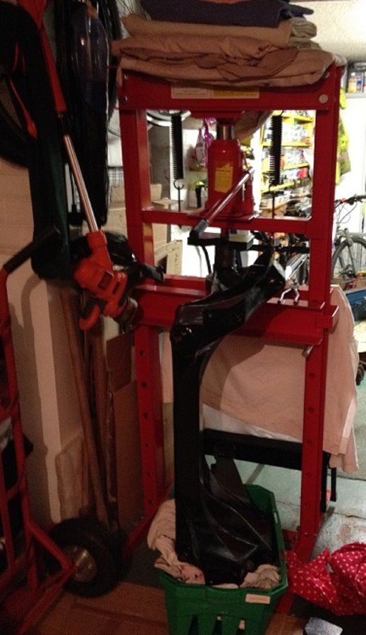

Just thought I would post a few pics of how I got on with my press. Thanks for all the advice. It was money well spent and just the job and made easy work of it all. I could have done with an extra pair of hands with the subframe but with a bit of help from an old Safeway basket it all came right in the end
Using a large socket to stabilise the wobbly wishbone
First one in to my relief and satisfaction

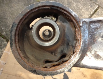

subframe bushes were well past 'sell by date'

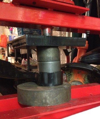

Using the old bush to press the new one in. Note I ruined this bush on the first attempt as I pressed it onto the metal plate underneath! Expensive lesson learned so used the two plates that came with the press on the second attempt!
Don't see many of these old Safeway baskets now eh - or not used for this anyway!

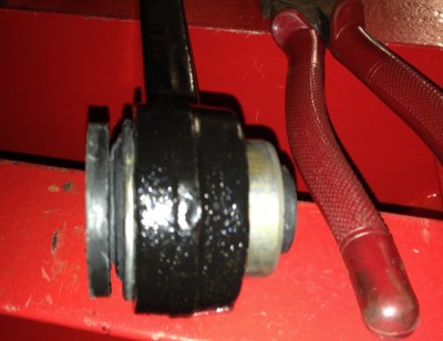

Both bushes in at last.

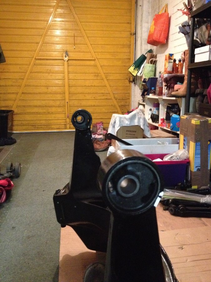

All of the bushes are now replaced with the subframe treated and painted up BUT since I sheared off a balljoint retaining bolt I need to sort this before I can get the springs back in. Currently painting up the underside of the car so this lot will go back in before too long with a bit of luck.
