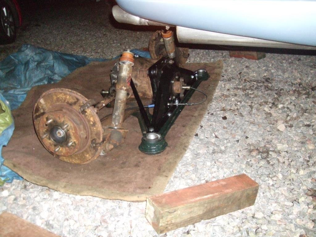

A short up-date. Working on the axle parts for Five hours today, in zero-temperature. The couple of pics below tell the whole story really, the rear axle has only to have the new springs to be put on over the 'not-so-old' shocks, and to be lifted into place and attached. The difficulty will be lining-up the spigot of the diff' to the propshaft, whilst lining-up the turrets of the springs........oh-joy. Don't underestimate how heavy this 'built-up' component is!

Well here we are, Two months later, and yesterday still in freezing temperatures and after Five hours non-stop, the rear-axle is finally in place. Hoorah!
You can see by the couple of pics that the 'solid' component parts have deteriorated with surface rust, the discs for example have only done about 2k miles. All bushes are new though, and the 'A'-Frame, and Pendulum, and Wishbone-Tie all have been refurbed. Also the 'Jurid' joint between the Prop-Shaft and the Diff' has been replaced, this was in particularly poor condition. I also renewed all the 'important' bolts that keep the suspension in place.
The first Two pics are just of the rear-end back in place. The following pics are very much of interest to those that may tackle this job in the future. My X300 is a 3.2, registered in May 1995, but the car was built quite a bit earlier than this. I think it must have had an early 'A'-Frame, perhaps off an XJ40, because the 'A'-Frame I've fitted, although the same dimensions, is definitely subtly different, and needs different bolts. As one example, the older 'A'-Frame has 'recessed' lower bolts upwards for the Diff' mountings, the 'A'-Frame I replaced it with has the bolts upwards protruding below the surface, (much easier to extract) (If in doubt, get XJ8 bolts) Now the first picture shows the 'A'-Frame mounting bracket, (one on each side) (And the thing that caused all sorts of problems when the car was new because it allowed stones to get trapped, and cause a very loud 'clunking' sound from the rear suspension. This was cured by a 'Hole' being machined in later brackets, of which I have fitted) Now back the the bracket, in the picture you see the Two bolts the same. Notice they are the 'Old' bolts! This is because Jaguars 'replacement bolt (Yes, I splashed-out on all Jaguar replacement parts) is the WRONG thread! (You can see by the pic, the two bolts the same size are rusty compared to the new bolt that goes through the doughnut, also you'll notice that the doughnut bolt has a rusty washer underneath, this is also the OLD washer because the Jaguar replacement washer is as thin as 'rice-paper' compared to the old one) In the other pics you can see the part number of the wrong-threaded bolt................if that isn't bad enough, this bolt is listed as the bolt that is on the outside of the bracket that is a size down! So not only have Jaguar got the part-number mixed-up, but the blasted larger bolt is the wrong thread! Look at the first bit of thread on the new bolt that I tried to put into the 'captive-hole' it's clearly damaged. These bolts are expensive at about £2 each plus VAT, and you must buy Five. If you look at the Jaguar part-number for the outside bolt it says, SH112301M. In FACT SH112301M is the inner Two bolts in the pic, that are the larger, and are the WRONG thread. And SH110201MJ (that is sold as the Larger bolt) is in FACT the Smaller bolt on the outside. (I didn't get the packets mixed-up, they were sealed) I checked the threads with a 'thread-gauge' and my bolts on an early X300 are imperial threads! WELL-WORTH-A-NOTE-I-THINK. You can see by the last pic, that comparing the bolts, the two Old bolts are a size smaller than the One larger bolt, and note the larger bolt is still new. Again note the damage to the first couple of threads on the bolt. (initially I thought it was stiff because of the 'thread-lock' on the bolt) I was lucky, I'm an Engineer, and could feel the bolt wasn't just going in very well. However, I know for a fact that some people may have used and 'air-compressed' impact driver to whack these bolts in place, and I fully believe that the bolt would have gone all the way in under those circumstances, surely weakening the mounting. Enjoy the pics, sorry about the long-post. For the last two pics I shall need to reply to the post.

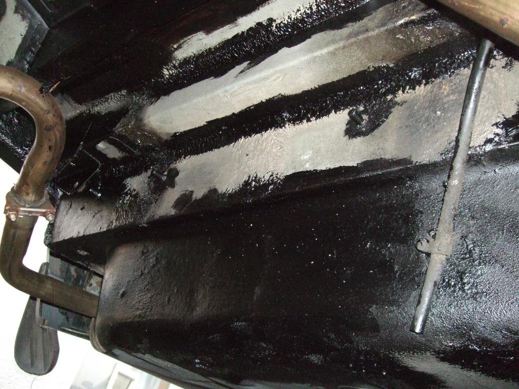

Today was very much milder at about 12 degrees C. So out and underneath the car to spray waxoyl the whole of the rear-end. The wind was about 30 knots, so I got a few blasts in the face, and a few swear-word with stuff blowing-away. Handbrake all hitched-up and tested, the rear-brakes now back in place with an experimental 'crack' of the 'new-ish' bleed-nipples. Next job is the ABS. I'll need to support the front of the car, and whip the wheels off, and remove the ABS pump with the pump-ECU underneath. This means of course disconnecting the brake-lines from the pump. I'll then attach my 'repaired' (by me) ECU, and replace the pump-unit attaching the brake-lines. Bleed the brakes, and then, Robert is indeed your Auntie! Once the car is back on 'all-fours' I'll need to scrape and waxoyl all the jacking-points, they've taken a lot of abuse in recent months. Then.............MOT. My intention is to 'repair' the replaced ABS 'Pump-ECU' and hopefully take pictures of the process so's others can do the job if they're confident when their 1095 code appears.
