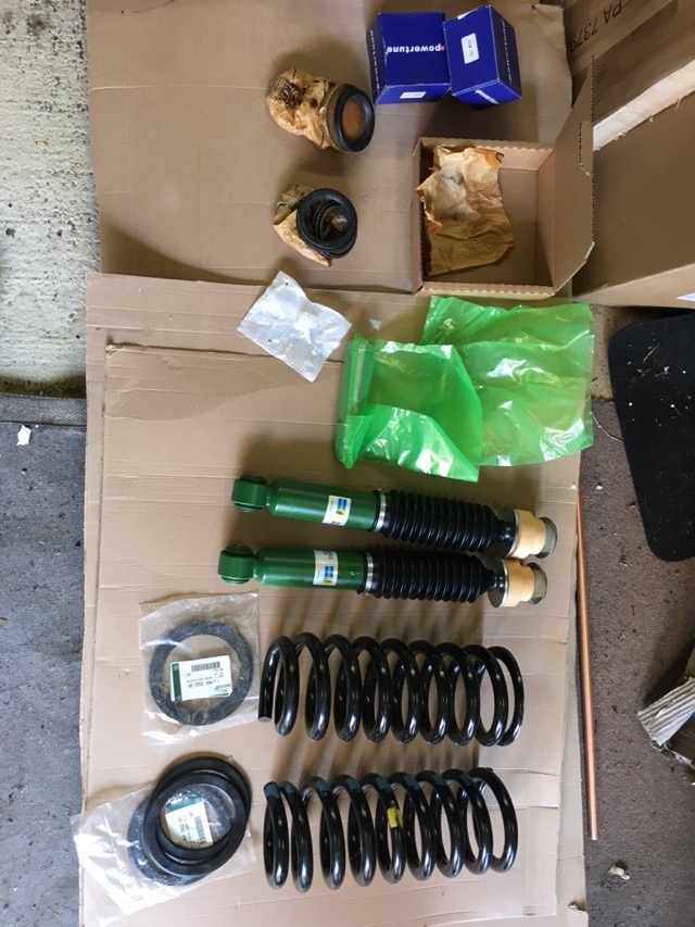

a pic of all the nice new parts i fitted
x4 wheel bearing sets,
x2 front stub axles
x2 rear sports dampers
x2 rear sports springs
x1 handbrake retainer clip ( for inside the rear hub )
x2 thin spring packers
x2 thick spring packers
plus a pair of OEM front damper lower bushes ( to the hub carriers ) to fit

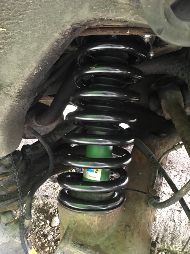

springs and dampers in place, and trust me, that was a struggle
