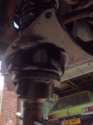

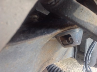

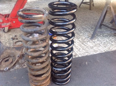

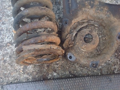

Re: XJ40/X300 front coil spring replacement
Hi,
A few pics of the right tool in use (guide pins not in yet). I decided to change the front shockers and springs after a big improvement following changing the rear. What astonished me was the state of the front springs when removed, and only 2 months since MOT.
I have 40 years working on cars and strongly advise using the tool. I bought mine from Bosch tools.£140.
Steve
