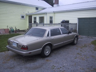

My 'old school' body man, here in Canada, has done this job for me several times on cars I have had over the years,(X300s). He cuts out the wheel arch from series 3 XJ front wings, which is the same profile as the rear wings on an X300, and welds them on, seamlessly. I defy anyone to tell the difference!
