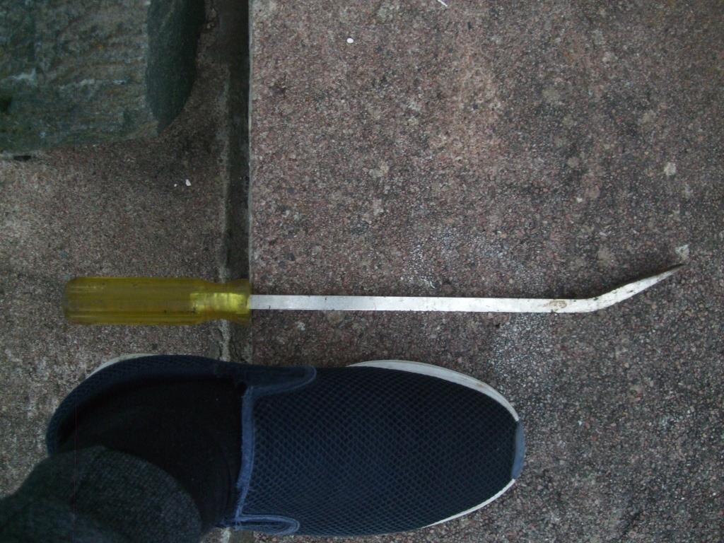

Hi Marcus
I haven't had this problem with my car, but managed to sort a mates X300, because I could look at mine and see how to gain entry, it took about an hour of fiddly work!
So I've put a few pics up, the screwdriver I bent to shape, it would have been better if it had been a thinner slightly longer one. You can see the angle it has to be, and the end points in a line from the nearside window washer. The small 'button' that the screwdriver presses, moves fairly easy, and if the cable is broken then it will still activate the catch. It still needs a firm push, and you'll still need to shove it under the plasticcover, which was the very tricky bit. You'll need an assistant to lift the off-side of the bonnet, and probably best to be another person with a mechanical bent that can feel how far to force the bonnet without permanently damaging it! The last pic shows the angle of the screwdriver, and length against my size 9 slipper. Good Luck! Let us know how you get on.

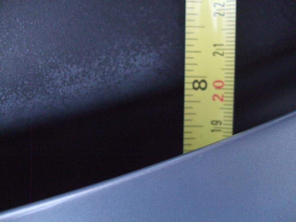

Marcus
OK, I went back outside with a couple of tape measures to give more precise directions. Both measures were bearing down on that 'button', and I closed the bonnet to let you see the measures to the button from the edge of the bonnet. Hope that's a bit more helpful.
1984 Mercedes 450SL Rag-Top
PeterDavisX300
- Posts:287
Re: X300 Bonnet Locks
The Eight inch measuring tape goes directly over the edge of the chassis number in the windscreen, the 15 inch measurement goes right oveer the top of the nearside window washer.

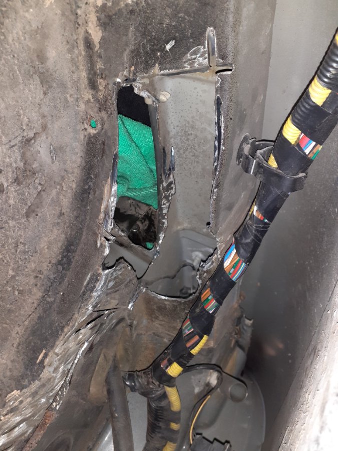

I ended up 'carving' a double skinned area of the inner wing
and finally released the 'latch' with a thin bent flat screwdriver!
This was before I saw your Post but thanks for the info.[pic=][/pic]
Think I cut more inner wing than I needed to but Hey Ho!
Adecent hole-saw might have helked but I only had a grinderette with cutting disc fitted.
Cheers.
Roger Goodman
Cable had in fact snapped and when I tried unclipping it to route it
so the end would reach the nipple it broke again!!
Have ordered a pair of new cables.
Suggest any one with an XJ40 or X300 check theirs very carefully (as it's not a job to tackle lightly).
Looks fine - but once the cable has actually broken you are in the deep stuff!
Only way to release then is to cut holes in the outer panel behind the wheel arch plastic trim
and then the 'box' section then the Inner wing panel.
If you can't weld a plate back afterwards the plastic trim under the bonnet hides the hole from MoT testers!!
