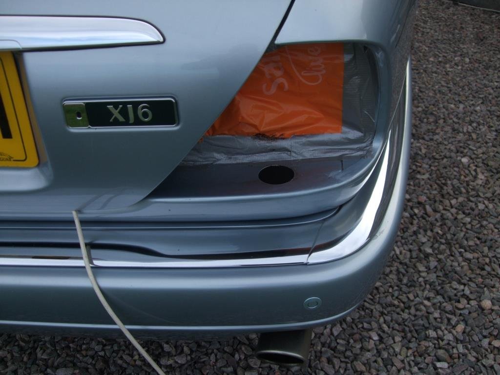

I had previously a few years ago found the start of what could have potentially been serious rust behind the chrome boot escutcheon, well this is very much the same sort of thing. Hidden, unless checked before it's too late, and not easy to get at the inside to prevent further problems. You can see the open area in the second picture looking down through the large round hole where the light covers the base.

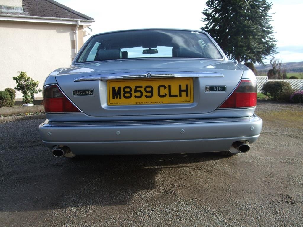

Once I'd opened this can of 'rust-worms' I decided to get the grinder, and grind both sides, and had to drill-out the drivers side. You can see from the pictures, the first one of the rear of the car taken in February this year, the car looking not bad with no real signs of rust. Then the pictures with the lights removed, and the rust removed from the outside surface, and drilled-out on the off-side. I held a small piece of mild-steel up to the inside, and a couple of blobs of weld. Then grind flat. I scrubbed the hidden area on the inside with a small wire brush attached to a flexi-drive off the drill, then treated all areas with Hydrate 80. Melted a bit of brazing-rod into the inperfections after grinding and smoothed it off with 600 paper. Painted. Job finished today putting the lights back in place.
