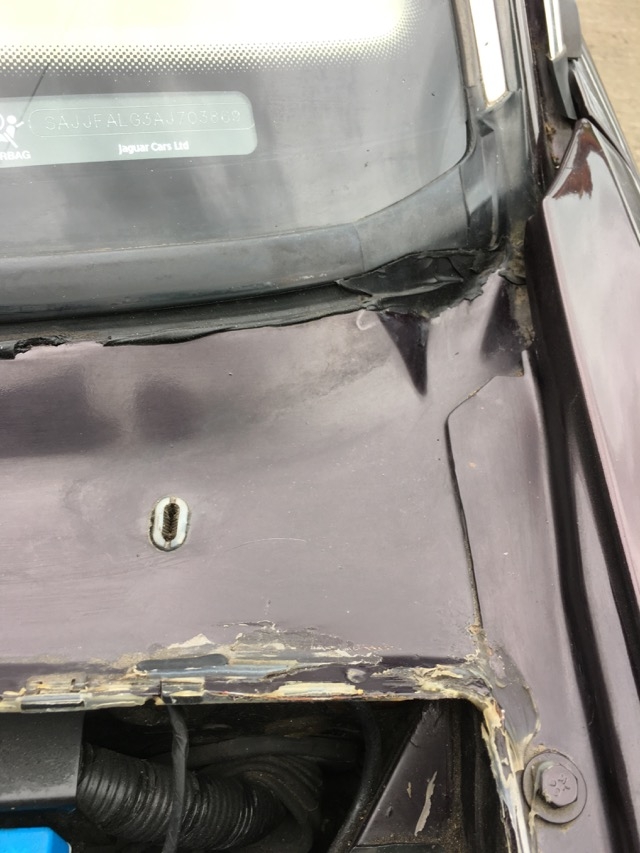

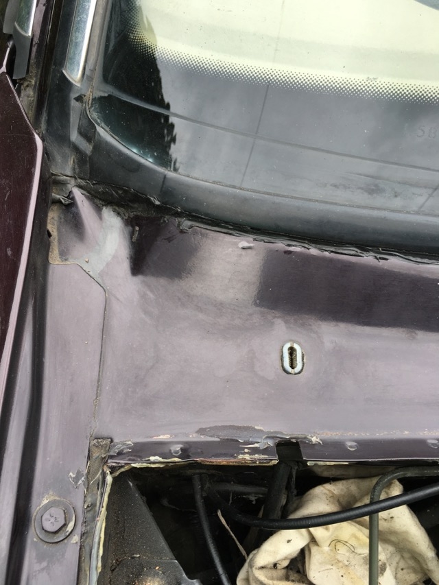

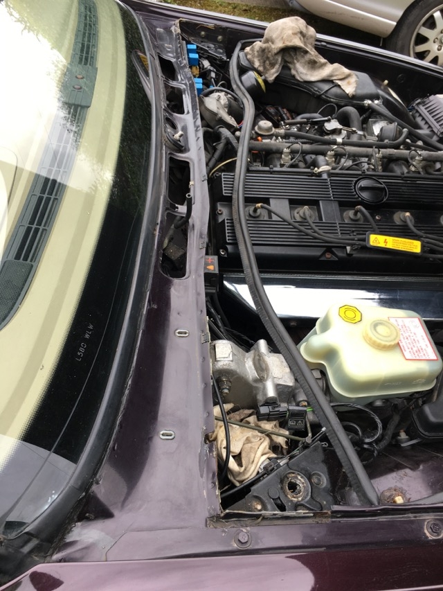

been doing a few small jobs, but i had to take of the wiper scuttle , it needed refurbishing, but more importantly i needed to ascertain the condition of the top of the bulkhead , to my relief it seems to be in great condition with no rot at all.......

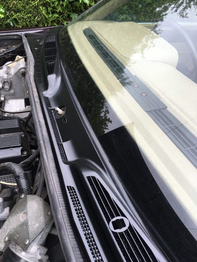

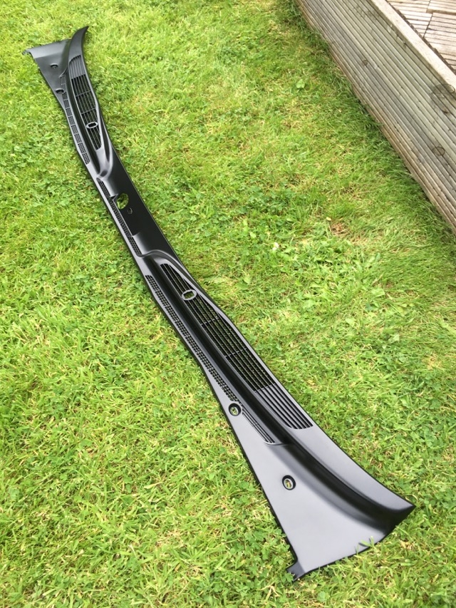

as with most, my wiper scuttle was decidedly faded and in need of some TLC
so after careful removal and disassembly of all the attached components such as seals and washer units , i set to with the scotch pad spending an hour to rub it down
then a good brush down with a nailbrush to remove all signs of debris in the vents etc, , then a wipe over with panel wipe
some plastic primer, and then a coat of body trim black ( i use Upol satin black from a proper auto paint shop )
i am very pleased with the results even if it only lasts a few years, as i can easily do it again
IMG_1039 by MyPix on Talk Photography

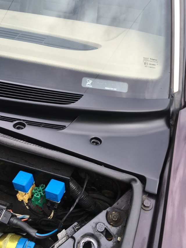

i have a few small things to do before fully fitting it, but i offered it up to get a taste of the look , lol

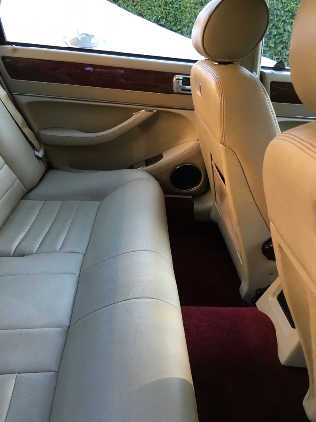

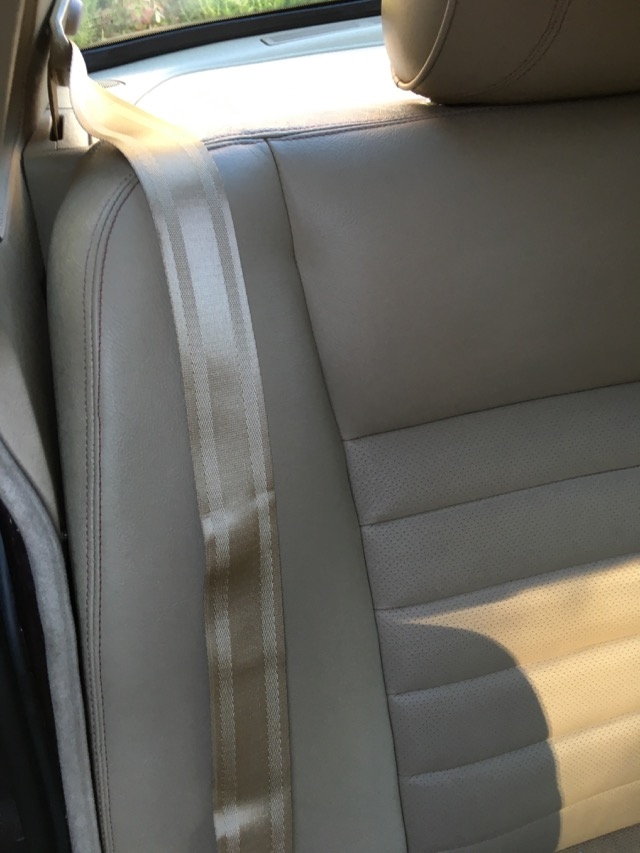

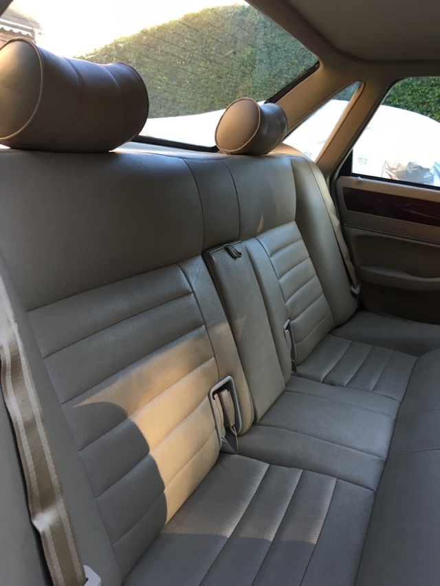

i finished cleaning the carpets ( Ruby red ones ) and took out the rear seat bench , i have a pair of new rear seatbelt to fit so gave everything a good clean , i also took out the rear parcel shelf for the seatbelt, and as up front, not a single sign of rust to be found around the rear windscreen seals ,
IMG_1054 by MyPix on Talk Photography
new seatbelt fitted and a good scrub of the shelf and the seats and it all went back together really easy , and is looking really clean right now ( inside at least )

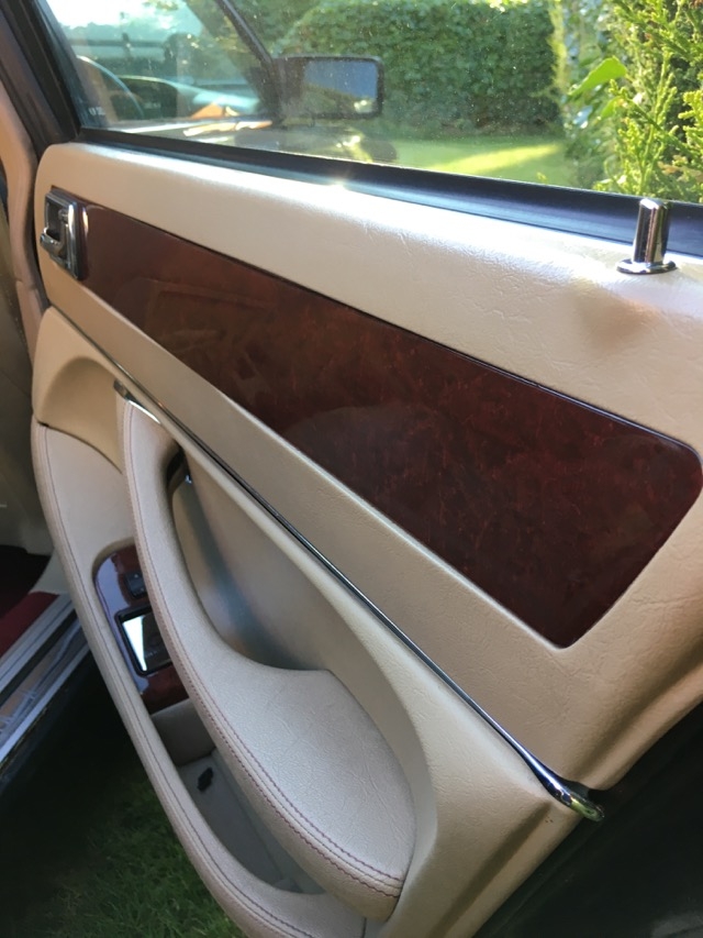

i also fitted full set of brand new door capping wood in birds eye maple Rosewood to the interior
