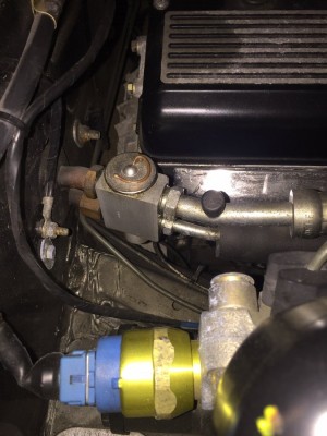

Hi, having had the opportunity to get my car out this weekend, with the eventful episode described in Engine under List (Lost) ignition, I believe I have understood all the controls now. EXCEPT ONE. As it was warm over the weekend I was not happy that when the heater controls were set to cold, minimum, as warm air still flowed through the vents. I tried the 'Humidity' controls but there was no difference what so ever, although I am not sure what they are supposed to do as there is no description of them in the manuals I have and very little in the Handbook. I do not even know if I have AC. There is a pump linked to the crankshaft pully below the distributor which is connected to the dash by some piping and I will insert pictures hopefully when finished typing. Hopefully also I will attach a picture of my dash so that someone with more knowledge than me can enlighten me as to what I have and what it SHOULD do. Hopefully whatever the system is, it should provide cold air in hot conditions and it's just not working. May need re gassing, new seals, or something replacing, which ever, I am sure it will be costly. I would appreciate some education and or direction of diagnosis please. Tony D

Going by the photo's it certainly looks like you have A/C fitted to your car.

A.J.P. Thank you for your reply and good news. I was a bit afraid, as the car is an import from Japan, that perhaps it was somehow different. The link is brilliant and I have digested it thoroughly but I have another question. I set the Fan control to High, selected AUTO with the mode button, selected 2 drops for Humidity and rotated the temp control to minimum and expected the system to pump out cold air. I took the temp inside the car before and after 15 minutes and the temperature actually increased. The engine tick over bobbles about and settles suggesting the pump is working when initiated so I am now thinking that perhaps it's working to a fashion and may need re gassed. Sods law it is filled with Feron 12 so I understand that I will have to have the system modified for new legally acceptable gas. So my question is, have I set the controls correctly to expect cold air, all things being working correctly. She is going to a specialist early next week but hopefully it's not just me setting the system incorrectly. Any replies appreciated. Tony D

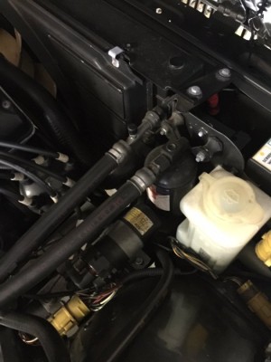

Sorry Guys but I ned to resurrect this post. My air con worked last year as above, although I don't think we had opportunity to use it, but when taken out of hibernation this year once again it didn't. I have submitted an article with more details for the magazine but suffice to say I have now changed the Receiver Dryer bottle, the expansion valve and removed the condenser and had it tested as they are impossible to buy, well almost. The condense tested ok and the system was rebuilt with new 'O' rings for all joints. My man at Polar Air re tested and re charged the system and it worked fine. That was a few weeks ago just before our planned trip to France which we have just returned from today. Yes, the B....y Air Con packed up on our return journey, although I think it gave up shortly after recharging, but we needed it for a 250 mile journey last Saturday when it was 37 degrees. Slightly frustrating to say the least. Now home I have checked and there is no gas in the system. There is tracer oil in the gas but I can find no evidence of it anywhere. My Polar Air man said, when we last recharged the system, that although the condenser may test ok they can become porous and leak slowly even though it passed vacuum and pressurisation tests. Can anyone spread any light on that theory please. I have not touched the compressor so may have a bad connection there, I guess I will need to fit new 'O' rings there too. Finally, I have only touched components in the engine bay and do not know what connections, if any, are under the dash coming from the two pipes behind the Expansion Valve, again can anyone share their knowledge or experiences please. I'll go web searching for a condenser !!!!! Tony

I must admit that mine also leaks, a specialist said it was ok and regassed it, lasted about 3-4 weeks. I now just regas it myself every 3 or 4 weeks, easy to do. Not ideal but other jobs are more pressing…
