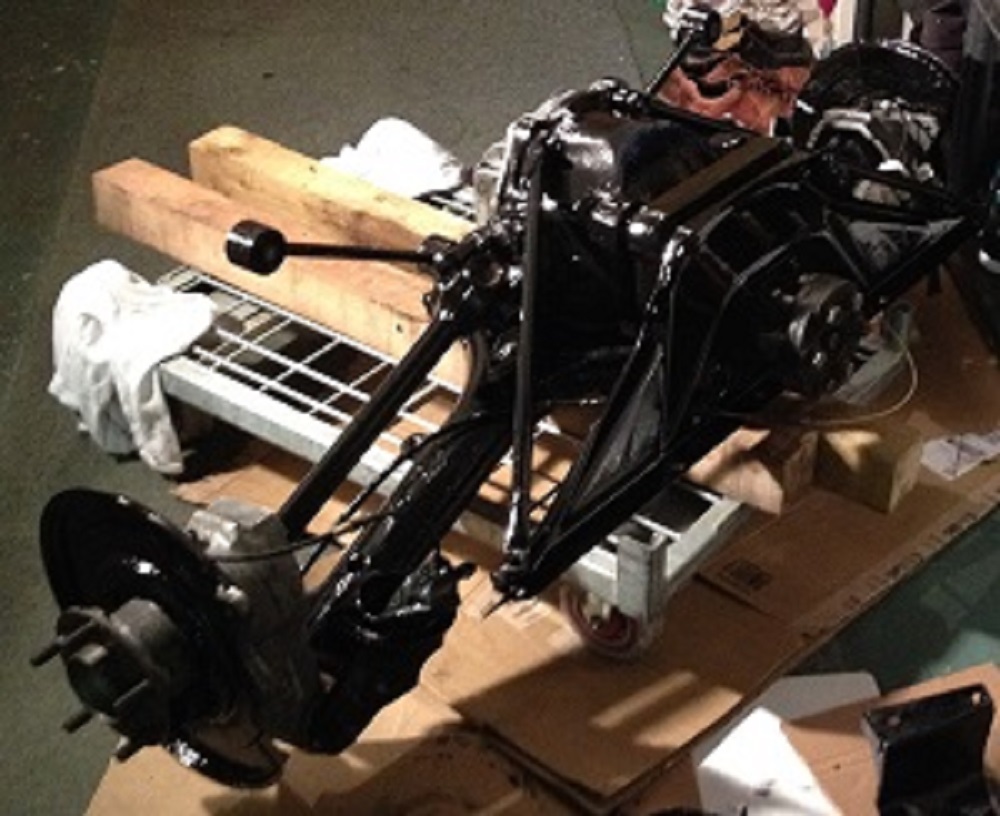

It's taken longer than I thought to get to this point but as you can see by the pic my rear axle is finally off the car. I followed Steve's step by step advice and was able to do it by myself so well pleased.
I decided to go the whole hog and remove the complete axle, wire brush it down and paint it up with POR15 because I had already taken the A-frame, springs and dampers off. It gives me the chance to make a proper job of it.
I will obviously be wearing a respirator and using eye protection but are there any do's and dont's that I need to be aware of regarding what to disassemble or not as I don't want to create problems for myself.

Re: Refurbing rear axle - hints and tips appreciated
I am no expert but like to think that I can hopefully pass on what I've learnt, to keep these fine cars on the road.
With regards to the axle (in my opinion) by all means clean it up/paint it but I wouldn't start undoing bolts etc, unless you absolutely need to.
One thing I would do though (before refitting):
Change and refill the diff oil - it's a pig of a job to do in situ!
Cheers Steve
I will follow your advice re the nuts and bolts and also the fluid change since bolts are stuck tight and there's little room for getting leverage when on the car. I have the day off tomorrow to get the wire brushes out but I have a feeling it will take a little longer than that so I will post a pic up of the finished product if it looks half decent.
In the end it painted up better than I expected
It's definitely got a rustic appeal when viewed close up but looks a lot better than before and hopefully it will be protected better now from the elements. Just need to re-assemble the handbrake shoes I took off the one side and then get the whole thing back on again.
looking good, a job well done I reckon. Not a light bit of kit though are they!!, I gave up pulling them out a few years ago as the hernias stated to complain bit too much!!
Very nice job Tim.
Now don't forget to do your diff oil change before you refit it!!
Thanks very much for the encouragement guys. I found out how heavy it was when I needed to turn it on the trolley to paint! Not easy at all and it's still got to go back on again. Quite right not before the oil change though so I need to get out and buy that and also 'rust proof' where it came out from now I can get to that part of the underside properly.

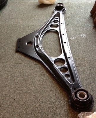

Diff oil duly replaced
Springs refurbished and ready to be put back with replacement dampers.
Not to forget why I started all this - the reconditioned A-frame/crossmember with new bushes.
