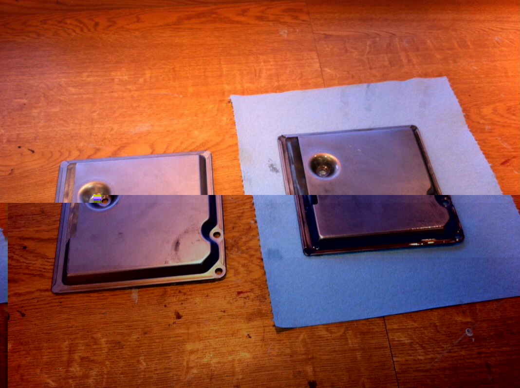

Could you possibly post a pic of the JLM664 filter when you get it? I guess you haven't still got the JLM2128 filter?
Wrong filter
Re: Wrong filter
Yes - I'll post a picture of the JLM664 when I get it. Unfortunately I don't have the JLM2128 any more - sent it back! However, easy to recognise that it's the wrong one as it has the pick up pipe.

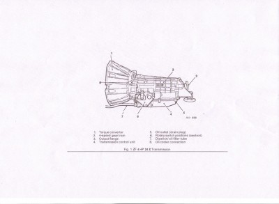

David & Paul,
With regards to the drain plug (if Jaguar stuck one where it should be!), I have attached 2 diagrams for your perusal.
Steve.
Steve.

Re: Wrong filter
Steve,
Tks for that. The diagram of the HP24 box is somewhat confusing. The identified item for the drain plug is pointing to a position way too high to be a drain plug for the sump. You couldn't drain the sump from there. It seems to be pointing just to one of the rear sump nuts, doesn't it?
Re: Wrong filter
Yes it does look too high.

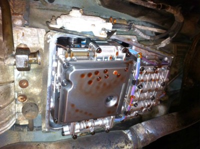

Re: Wrong filter

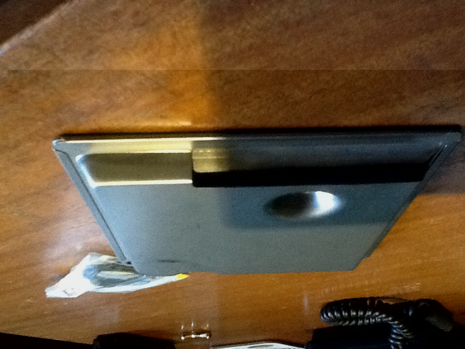

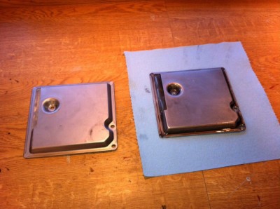

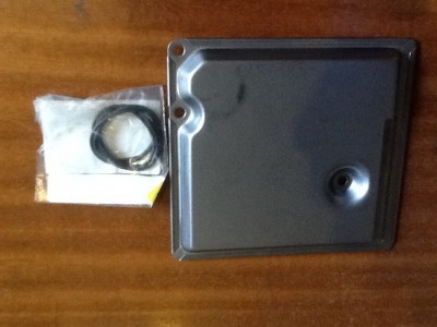

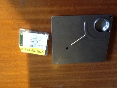

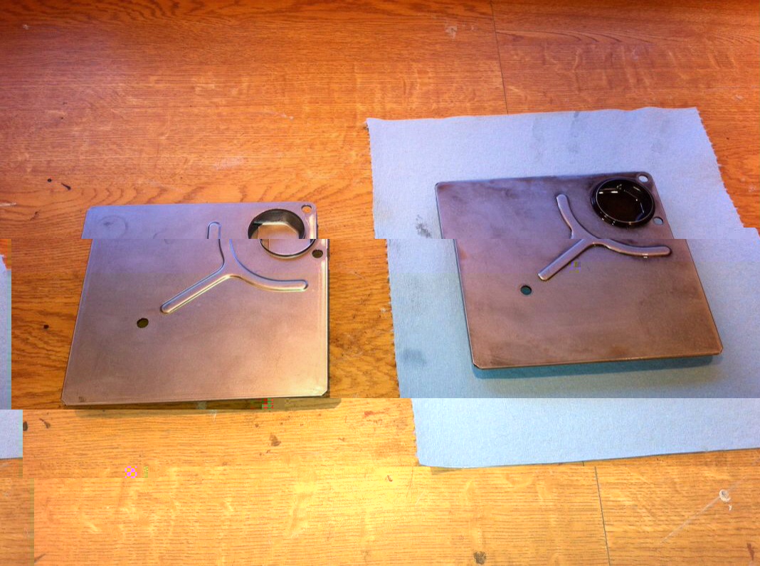

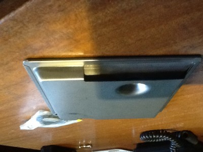

New filter arrived today. This is a genuine JLM664. It looks right to me. I'll go and fit it this evening if she who must be obeyed allows me out to play!
Sorry - for some reason all my photos have appeared on the site upside down. Bloody computers!!!
Re: Wrong filter
Have now fitted the new filter and it fits! So it would appear that JLM664 is the right part for the late 4.0 ltr cars
