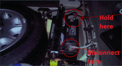

Sorry, so long since I replied, I no longer have a Jaguar, but still like to keep up with the mark. Re, your problem. You could try a couple of things, You can look this up on the website. Disconnect the battery for more than 2 hours, this might do a re-set alone. There is another thing that can be done, that is, you leave one of the terminals disconnected, and hold that lead onto the other terminal for more than 30 seconds, this does a 'Hard' re-set. JUST REMEMBER, NOT TO HAVE BOTH BATTERY TERMINALS CONNECTED!!! I can't remember whether you disconnect the negative lead from the battery terminal, and hold it onto the positive terminal (with it's lead connected) or, the other way around. This would maybe do the trick. If not, you need someone with an Carsoft i930 reader, about £110. I've got one, but I live in North Scotland, and all my gear now turns toward Mercedes' of the 1980's. Another thing you might check is that the venturi-flap in the inlet side is spotlessly clean, any filth in there, and she'll tick-over on the high side. In fact, I would check that first!

Just to clarify,disconnect the NEG cable and hold it on the POS terminal. Hope that helps.I can't remember whether you disconnect the negative lead from the battery terminal, and hold it onto the positive terminal (with it's lead connected) or, the other way around.
Good luck and take care.
