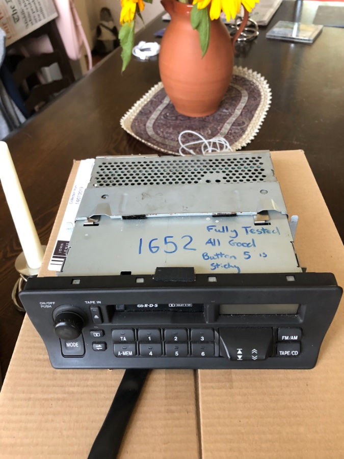

Morning all, I am looking to replace the horrible Kenwood radio in my 1997 x300 Sovereign for an original standard radio.
I have looked on e bay but there are all kinds of different ones! can someone please post a picture of the radio I would need as I don't want to buy the wrong one. Mine has a CD changer in the boot.

It’s a AJ9500R I think.

Hi Keith, sorry it’s not for sale.
It was just a picture (as requested) of the correct radio that I took before installing it in my XJR6.
I believe (My specialist got it) it came from Simply Performance, who stock lots of second hand parts. It may be worth giving them a ring https://simplyperformance.com/contact/
Good luck, the sound is outstanding if all the speakers are in good nick. Luckily mine are, but the original radio was very dead, hence the replacement one in the picture.

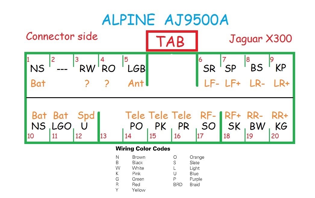

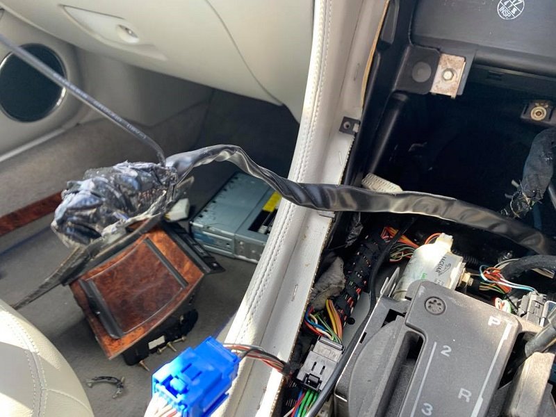

Hi again, I have removed the modern stereo to find a right old hotch potch of wiring!
Can someone please tell me if the white connector block is for the standard AJ9500R Radio?
Also the single black wire was spliced into the stereo any idea what this is for? it came from a totally separate cable

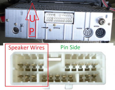

One last thing... what does the CD changer plug look like as I'm now not sure if it's there at all?

Postby cafcpete » Tue Apr 28, 2020 4:31 pm
Yes the white connector looks like the correct one.
There should also be a thick black earthing cable (The one you have with the spliced earth lead) that connects via a nut at the back of the radio to an earthing stud on the car.
The CD should be a round DIN table connector. There will be two of these if your car has the upgraded audio (sub woofer on rear shelf), one for the cd and one for the amplifier.
I attach a couple of photos take from here https://www.jaguarforums.com/forum/xj-x ... -a-204735/

Postby kmorrison2011279 » Tue Apr 28, 2020 4:38 pm
That's great just what I was looking for. I have the din cable for the CD changer but alas I don't have the amp upgrade! However I do have the braided cable used for an earth.

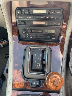

Postby kmorrison2011279 » Tue May 26, 2020 12:55 am
Job done, have a fully working clock display too, looks much better
