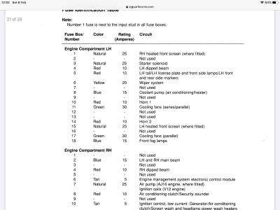

Re: Engine cooling fans
Really blurry when zoomed out; is that 11 and 30 for the fans?
