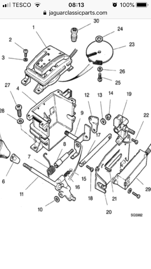

The suspect part is no. 29 in the attached parts drawing which is the linear switch part no. DBC12395 for cars with vin upto 737934
Or LNA6550BA for cars with vin from 737935
There is also a microswitch that can be troublesome, it is pictured attached to no. 20 in the drawing. Part no. MMD4940AA
Apparently the linear switch can be cleaned and adjusted which could cure your problem

I'm struggling to find a micro switch on part 20 though.

After another inspection I assume you mean the switch at the top of the plate.
I've put the part number in on several sites and it is not recognised.
Jaguarclassicparts.com seem to be the only ones who recognise it.

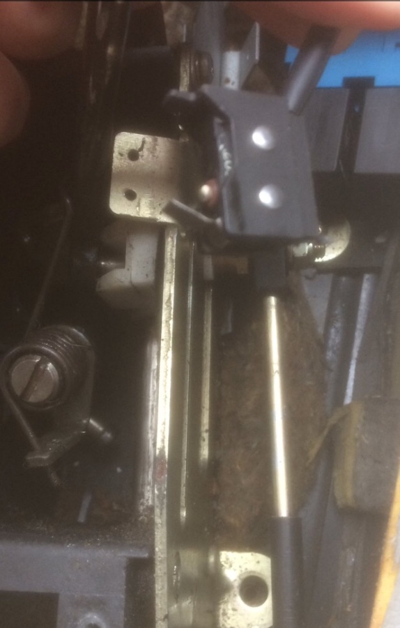

Here is the micro switch, mine was broken off it’s mount and the metal arm was snapped. It is worth checking the switch is depressed when the selector is in park, it may just need some adjustment by bending the small metal tab for better contact.
Also before taking it apart there is a small amount of adjustment on the linear switch by loosening the 2 screws and sliding the switch back or forth
