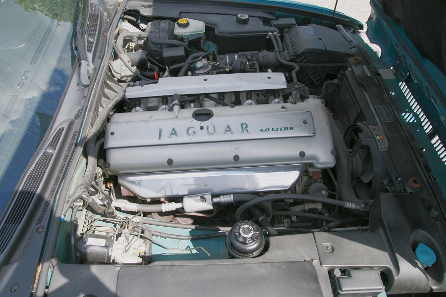

I plan on doing everything myself - where possible. I had been looking for XJ for sometime - then this daimler popped up roadworthy but in need of some TLC.
I'm currently running on 5 cylinders and fault finding the plugs/coils at the moment. I have a rocking motion at idle which wasnt there before. I've put some miles on her recently so i expected something to let go.

Been going well so far. I have addressed some issues and have learnt of some new ones in equal measure.
Rocking engine was cured with a new set of plugs and two new coils. Purrs lovely now...
