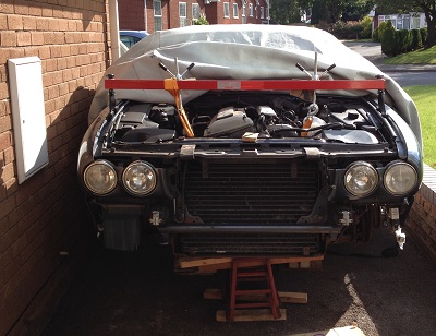

This thread seems to have died a bit of a death which is a shame. I have taken on board the suggestion that members should feel encouraged to post up pics of work doing on cars and so I am posting this to see if it uploads. I was struggling to get pics up but I think it must have been my total lack of IT skills. I think I need to challenge myself to post up more rather than just asking for help when I get stuck. I must say though that I still feel that there is lots of work in being a forum coordinator and I sometimes feel guilty keep asking questions and I am sure their wives and partners want some of their time too.
So here is my car raised up very high with the bonnet off and engine suspended from above and subframe removed for re-bushing. N.B. my car is unfortunately outside. I had to remove the subframe due to rot where the subframe bolts to the car.
If this pic is uploaded then I can upload more if anyone is interested. I think sometimes pictures say a thousand words. Please can people feel free to say where I may have gone wrong on anything I might post. Sometimes there may have been an easier/better way and we can all learn from sharing our thoughts and experiences. Then if we are unsure we can check with the forum coordinators for best advice and can private message them also. Forum coordinators please feel free to correct anything I may put up which might be wrong or unhelpful to others as this is helpful to me also.
Steve, Naki and Rob have all been brilliant in supporting me with the ever ongoing work and Steve and his wife even popped in when driving home from a rally to offer advice, what more can I say! I can't thank you all enough so your thoughts are most welcome and I hope that if I post a bit more (as inexperienced as I am) and that is the right thing to do then I am playing my small part in this excellent club. I wish I could come to the rally's but arriving in a Scenic just does not do it and this is the only Jag my wife will allow on the drive
All thoughts very welcome
Cheers Tim
Cheers Tim

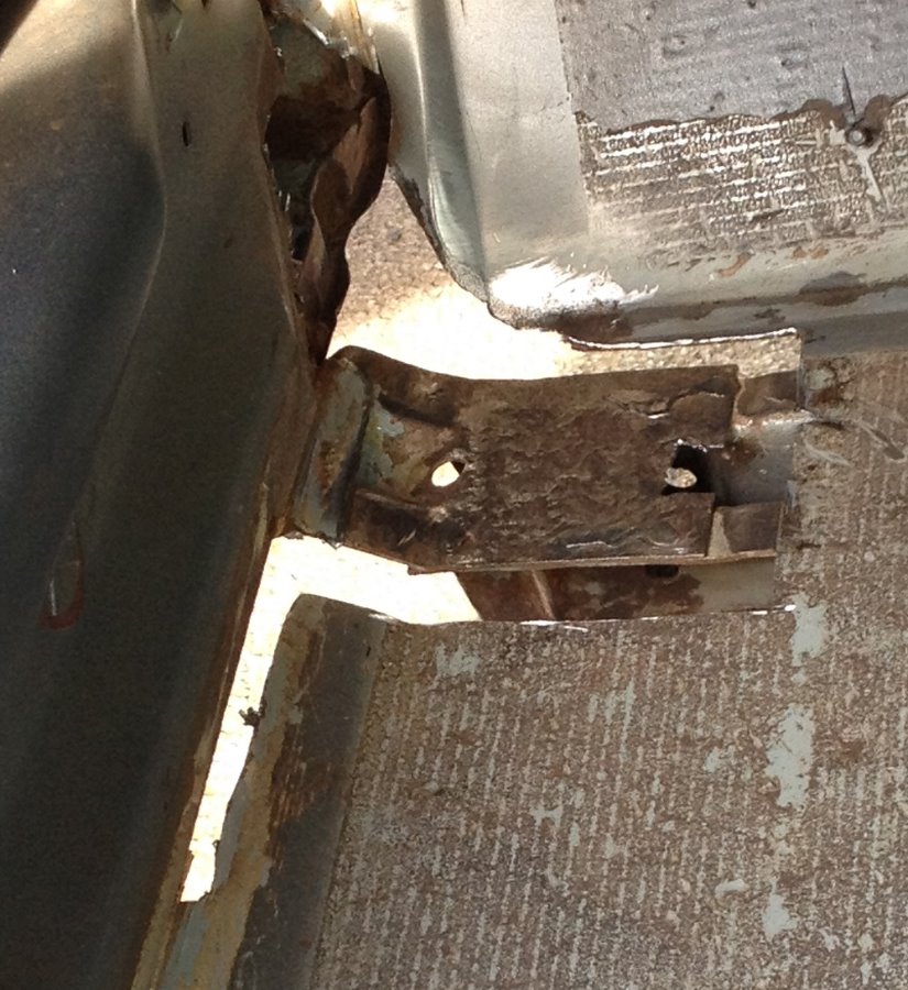

Thanks both of you and I think you may be right Steve as there was a lot of hammering in that corner. I watched him work to pick up on some tips. He plated it, which works for me. I want to have a go at a hole in the back end of the driver's side sill but he advised I convert my welder to gas first. The wheel was in the way as it was on a ramps at the back. Here are the before, mid and after pics of that side. I cut it out myself to save money and treated and painted up afterwards. The underside is now painted up but I am going to put Gravitex or something similar over the top to keep the moisture out.
The other side was the same but it was the rust where the subframe bolts on that was worrying and why I removed it.
The work continues
Thanks Tim
The work continues
