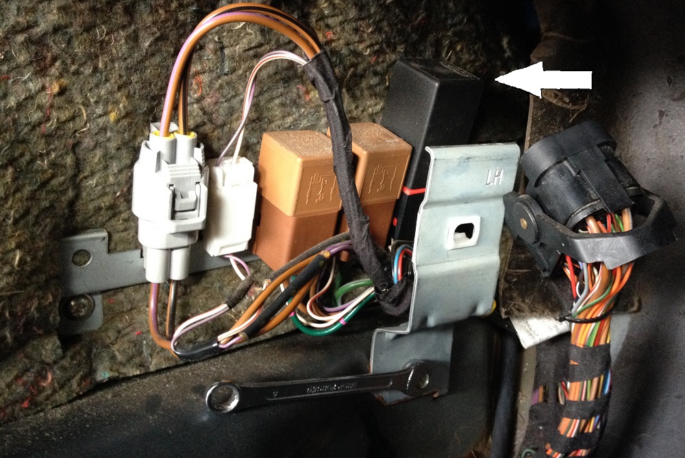

O.K. so getting back to the point here is a pic of the offending inertia switch. The top is rubbery so just pressed it to reset, simple when you know how.
Located LHS footwell - hope this might help someone else at some point.
