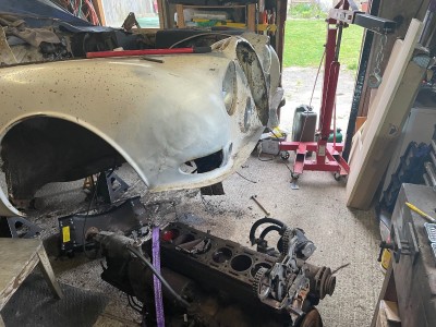

2 The engine mounting bolts were all slackened and appeared that they were going to come free so I applied the two trolley jacks to release the engine and gearbox weight and applied the sling and positioned the crane.
The moment of truth, I gingerly undid all 8 bolts and removed they whilst tweaking the jacks and engine crane to ensure no sudden movements.
It was a bit anti-climatic as nothing happened once the bolts were removed - it appeared with jacks and crane I had perfectly balanced everything so now to try lowering whilst checking on/for the cables I hadn’t freed.
The engine began to drop very smoothly with the only pain being the auto-transmission dipstick/tube which is extremely rigid and fouled on the accelerator pedal linkage and required some manaouvering.

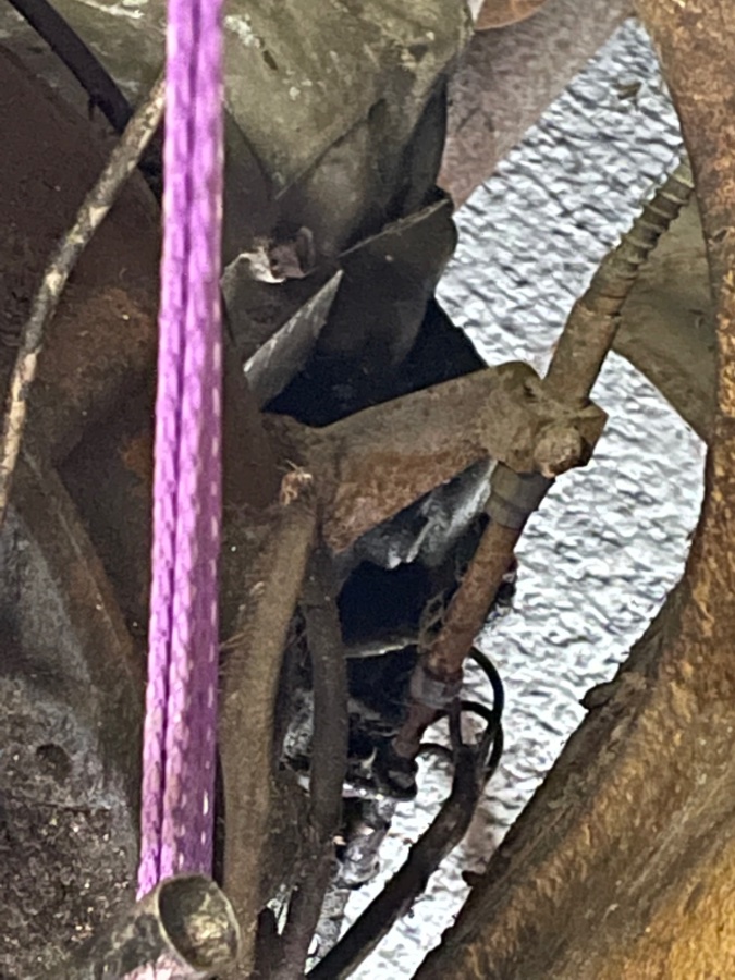

Once I’d dropped about 12 inches I could see at the back of the bell housing the bracket and ‘stretched’ selector cable. Seeing and accessing were two different things! I ended up lying across the front wing and over the top of the engine to reach back to free the cable and bracket. I know reassembly is a good while away (years?) but I need to work out the proper method for reattaching the cable as if the cylinder head and cam covers had been in place I would have struggled to reach.

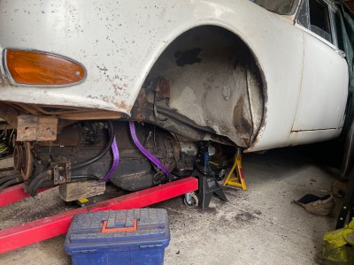

The engine is now sitting on the floor below the engine bay on a pair of wheel trolleys whilst I work out how to disconnect the speedo cable, and also how to get it from under - I’ve either got to tip it over of lift the car 10 inches..

Well I managed to get the front of the car a foot higher and with the application of a Dremel the speedo cable is off so engine and gearbox are now tucked away until their turn- now no excuses for welding at the front!
I think my next step is to construct a more secure platform to hold the car up I’m thinking in addition to the axle stands, a 3’sq fence post across the chassis members on breeze block piers- has anyone any good experience of supporting a vehicle with the front high in the air?
Whilst I have wheel chocks in place I’m conscious that they are not foolproof and safety needs to be first.
