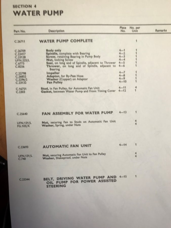

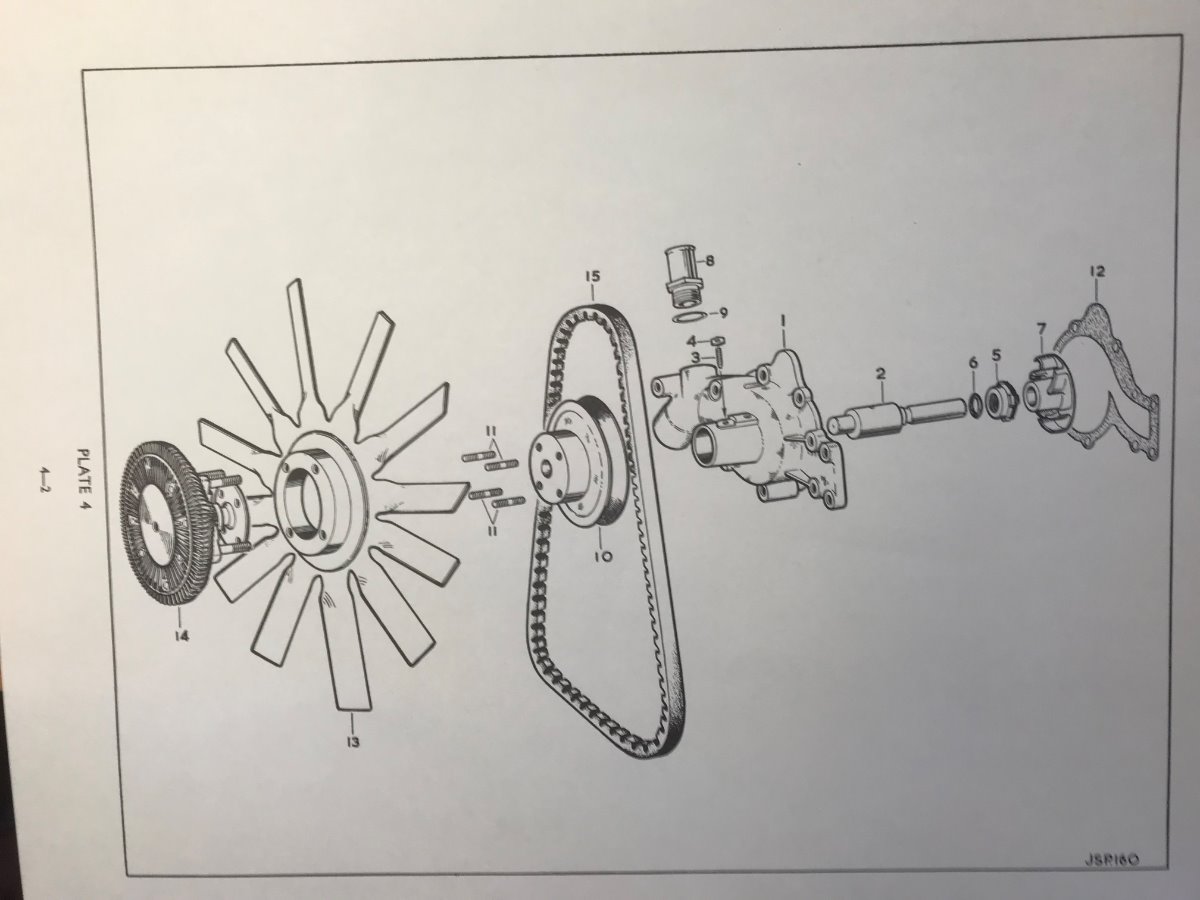

This maybe a complete Red Herring but check out the part fitted to a 420.
My Daimler 420 has got a viscous fan coupling. The part number I have is C.23693.
See the images below.
