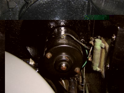

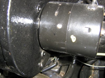

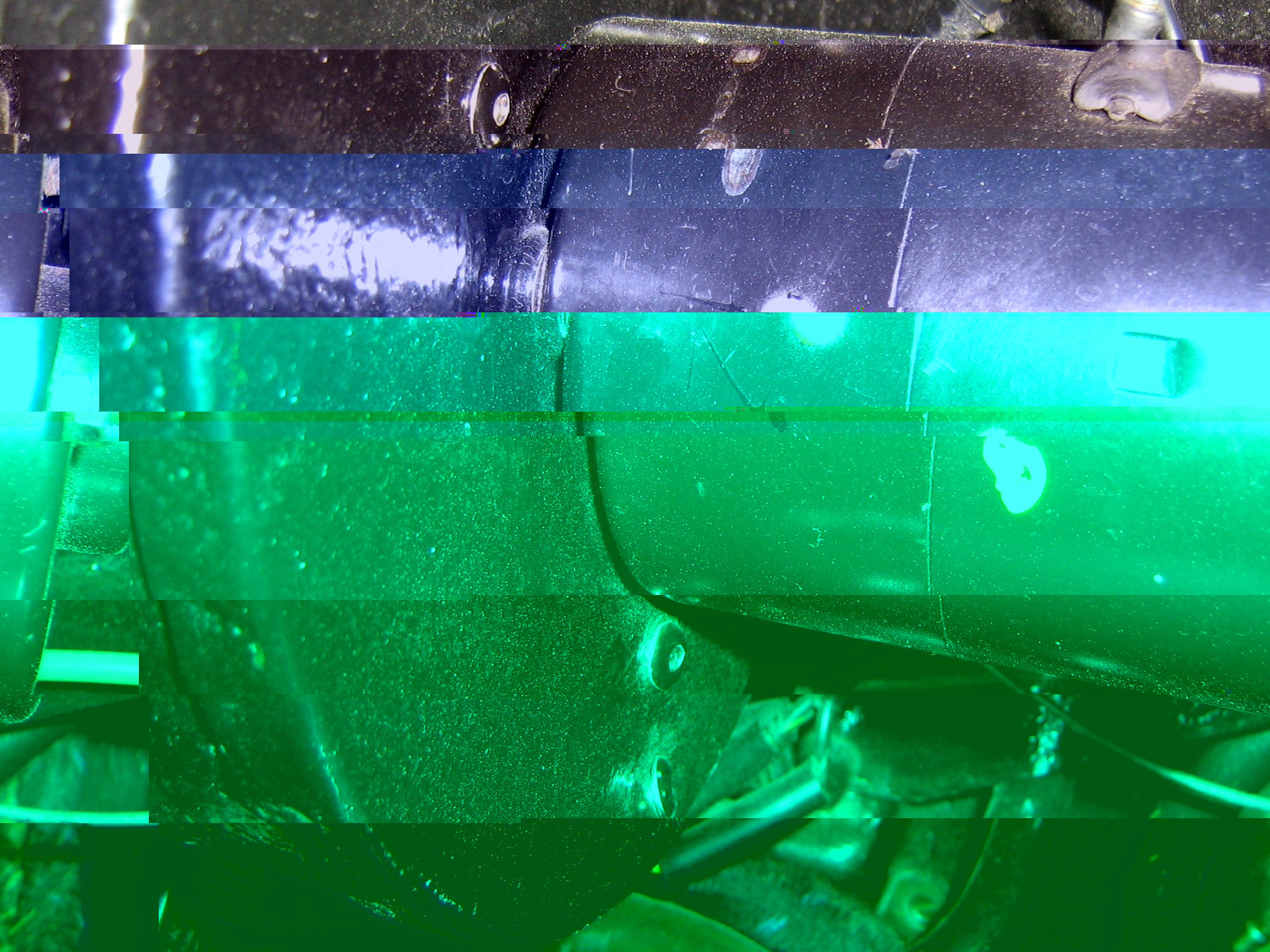

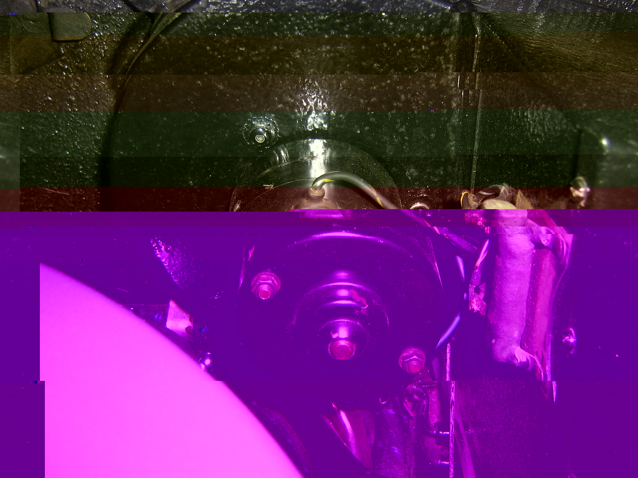

Hi Howard
Please find the attached photo's and a few lines on how I converted my Mk2. Using a Metro heater motor and plastic fan/impeller should improve the amount of heat pushed into the car or onto the screen. Although not a straight bolt on, it really doesn't take much. I used the two metro motor body screws to hold the motor onto the heater box, this just means drilling two new holes and fit rubber blanks into the old ones, in order to mount it this way I did have to open up the centre hole a little to get it to sit close, I also used a couple of small grommets between the motor and casing rather than just hard mount the motor.
From memory the 420 and S-type heater box has a panel that carries the motor and fan/impeller.
While your taking all the trouble to fit the new motor and fan/impeller, remember to ensure the matrix is well flushed out and all the flaps are working correctly with seals in place, also ensure that the pipes to and from the heater are clear and clogged-up. Once all fitted back on the car, bleed it through at the heater to ensure no air locks.
Warm motoring

Re: Heater Upgrade
Thanks everyone for your responses, they are certainly food for thought and i think I will start by trying to obtain a Metro fan and weighing the job up!
I have seen the pictures posted by ecosse lynx which give me some idea,
Again, many thanks,
Barry
Again, many thanks,
Barry
