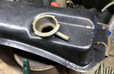

If you get into 420 header tank problems, be aware there's at least 2 types.
One has an inlet/outlet to the engine block (as the one on my '69 420 does), whereas the other type doesn't.
i.e. One type has two fittings, the large inlet/outlet hose, plus the small overflow outlet above the radiator cap.
The other has three fittings the large inlet/outlet hose, the small overflow on the rad cap and a third inlet/outlet with a narrower hose connection back to the engine block.

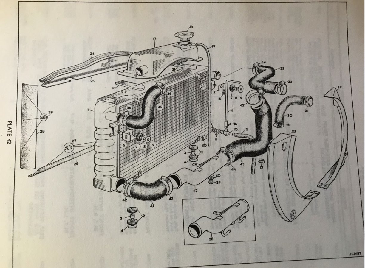

Some images of the 420 header tank variations.
One from the official Daimler spare parts catalogue showing just two hose connections.
The other, a picture of one end of my header tank showing the 'additional' small inlet/outlet on the side that takes a hose connected back to the engine block.
