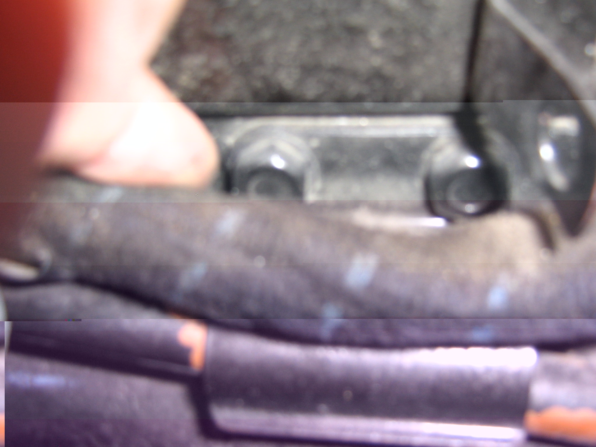

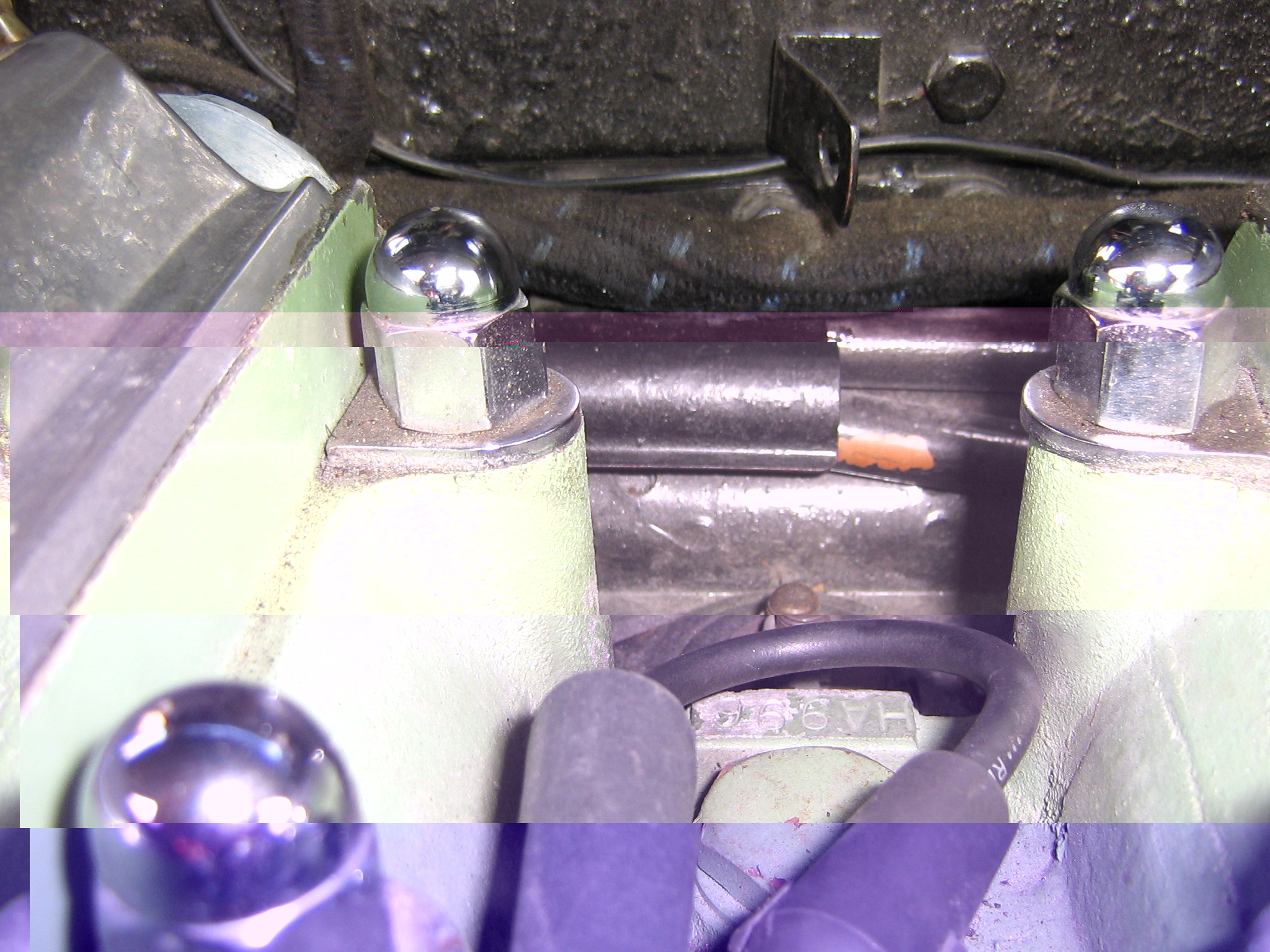

ecosselynx
- Posts:265
- Joined:Sun Sep 02, 2007 12:08 am
- Location:Magnou, France
Re: Mk2 Cooling pipes - support brackets?
Hi Richard
Sorry for the delay, eventually go the photo's.
bye-o
John H.
John H.
cortinaman
- Posts:10
- Joined:Tue Apr 16, 2013 12:10 pm
Hi John
Thanks for taking the pictures - much appreciated. Mine is lacking the supporting clip/bracket, and I'm not even sure that the holes in the bulkhead are there for it! I think I'll try and fabricate a copy of the bracket - but for now cable ties will have to do.
cheers
Richard
