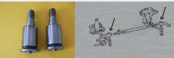

I was hoping there would be a PU option to the steering pivots
On the superpro website https://www.superproeurope.com/products ... cleid=7384 it does list a Draglink bush but they look too chunky to me.
