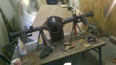

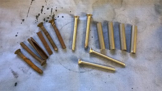

It's a long Job , so I would say a winter one , I made my spacers out of polycarbonate ,nothing left of some of the rubber ones .
Your be lucky if you can re-use the tubes and bolts, I replaced with s/steel .
I gave my leafs a coat of chassis black , then loads of wax oil , mixed with old engine oil , to keep things moving !
Good luck .

The s/steel bolts in my pic are not under load as such , they just keep the long springs in line
