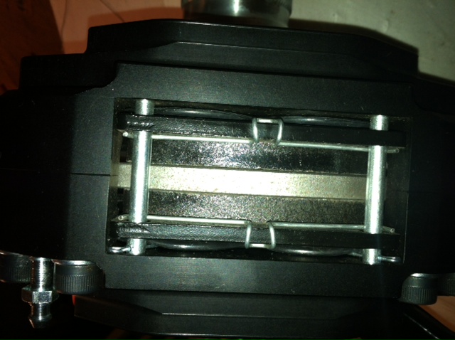

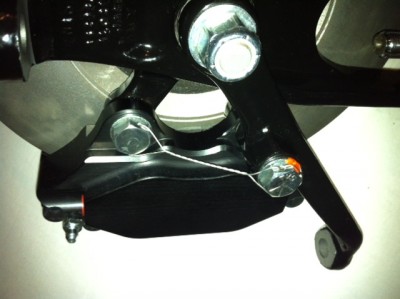

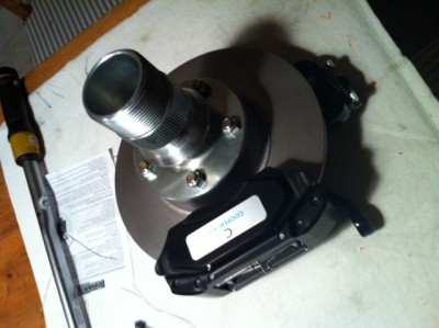

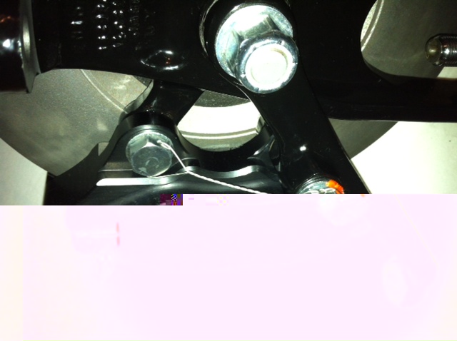

About the brakes: still on the bench but finished and torqued and safetied.
The pads touch lightly.
Take a look:
oldtimer
Posts:1311
Re: Castor shims
Postby oldtimer » Tue Jan 14, 2014 7:04 pm
Hi Bernhard,
That all looks superb - well done.
Oldtimer

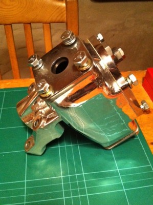

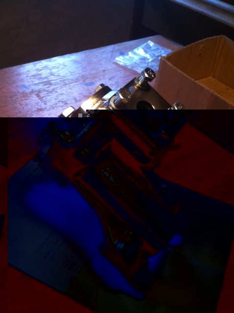

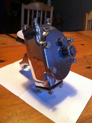

A few days ago I could not keep my fingers of the steering box and the idler plus all the attachments. Trying to change the oil I opened the topscrew and nothing came out, I could just see thick grease. I had found some original Castrol D104 on ebay and checked the viscosity, very different. So here the little engineer had to open the top and Wow, green slime from Mars is probably a fair statement or maybe warm chewinggum on shoe soles. Unbelievable. Now I started to remove that stuff ..... I dont want to go into those details, just 50 years old elastic stuff.
Now here I loosend up the spindle screws a bit to spray brake cleaner into the bearing and POP, out comes one of the bearing balls. Sh..t. Now trying to put it back in, released 9 balls on the opposit side. This did it. Now this screamed overhaul.
The result can be seen on the following pictures (just temporäry fitted since I am still cutting sealing papers for the shims.
Just could not resist! More information when I am back home again on the weekend.
