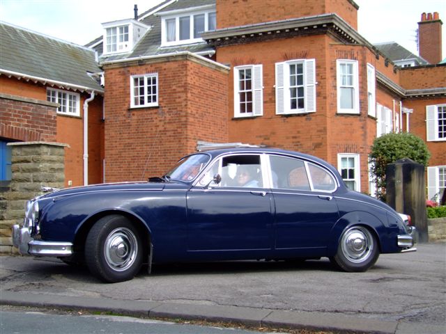

Below is a picture of our car many years ago on a rally, the fronts are about 1/2" too low and the rear about an 1" higher but there is a big gas tank in the boot.

Re: Replacing rear springs
Hello Brian,
it may be due to the uneven surface but that looks too low at the rear to my eyes?
Alec
Alec
