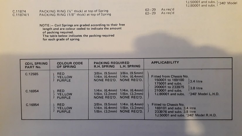

I have an official Jaguar parts book but for the 3.4 and 3.8 only. The spring you listed is not in my parts book so it probably is correct. Originally these springs were colour coded which code also indicated the thickness of spacer to fit. Using spcares is designed to level the car, but as you quite rightly say it will lift the ride height.
Springs do take on a set after initial fitting and in your case may be exacerbated by slightly lower rear ride height due to old rear springs?. That said I don't think lifting the rear will reduce the front by any significant amount. Practically what I would do in your case is make up some spacers to go between the spring pan and the wishbones to adjust the ride height. It will be some trial and error due to the geometry, i.e a lowering of ride height by 1 " may only need a spacer of 1/4" for example (Purely a guess on my part).

Thanks for the reply, firstly the workshop manual for the 2.4L advises that a spacer is not necessary for front green springs.
There are threads regarding "lowering" the car by insertion of a spacer or spacers between the lower wishbone and the spring pan which keeps the same spring length and there is a ratio as you point out. I think 3/8" gets you a 1" drop or something like that. However what you loose is clearance between road and lower spring pan of course, not major but something to consider.
Based on the spring tension on the spring pan, which is considerable I would be happier with a spacer plate on each side of the wishbone arm, rather than a handful of washers to achieve this. However I am still not sure exactly what the ride height should be, floor to top of wheel arch, so it's all a bit subjective.

my parts manual gives the spring colours as a combination of three and depending on those should be matched with a spacer. However, despite what is published, if you have an uneven height I would correct by shimming. There may be a contribution from the rear but shimming the front is the easier option?
When I suggested shimming the spring pan, I had in mind a full size plate covering the full outside area of the wishbone. Washers may be satisfactory but I don't like the idea very much. I don't believe lowering the spring pan will give any clearance problems as the amount is so little.

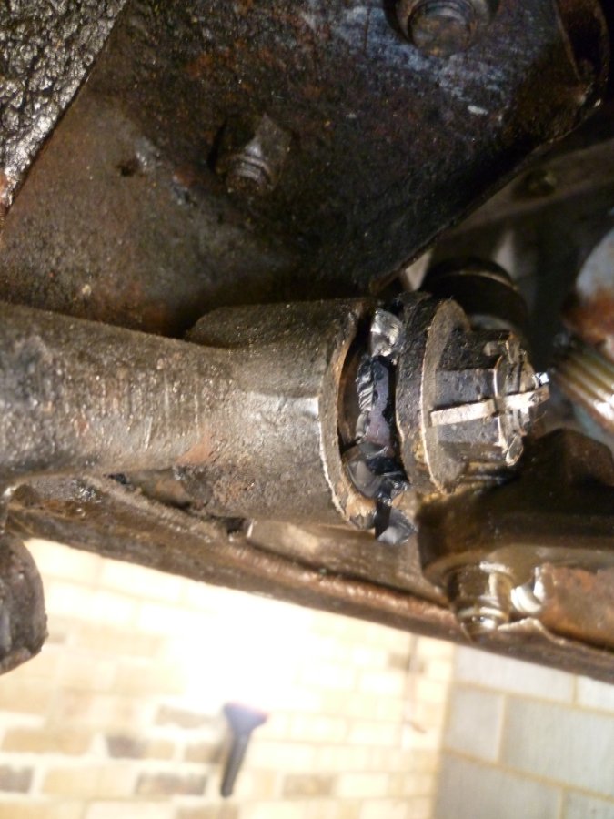

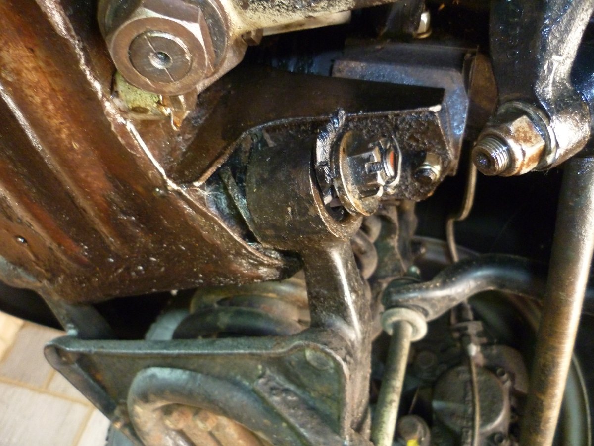

Hi, this is not about ride height but about replacing the bottom wishbone bushes. I am hoping the same respondents would read this.
my problem.
The front suspension was rebuilt in 1997. Not many miles ago.
All 4 lower wishbone bushes have suddenly broken up.
The rubber looks pristine and might be PU. They are not the metalastic standard bush. They have big flanges which are where the tears have started and mangled the rest of each bush. It is a bit weird them all happening together. I don’t think it was an animal. The suspension was hanging for an extended period with the wheels off.
If they are the split PU bushes which rotate / slide (with lubricant) on the spacer, I am hopeful they will disassemble easily and the shaft can be knocked through.
I was hoping to do this on the car. If I have this wrong please tell me.
Of course I will need a good spring compressor to contain the compression force from the spring. I have asked Ken Jenkins for details. I was hoping someone who had used the studding method would have a photo or could make a sketch or describe the arrangements. A PM might be best.
