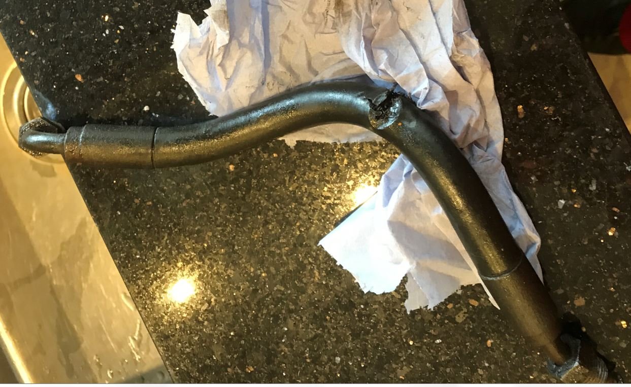

The problem was caused by the pipe chaffing/rubbing. Over nearly 50 years it eventually became so weak it burst under the high pressure from the pump. It was a nightmare to get off, I just about got a ¾ inch open-ended spanner on the fittings. I also had to remove the low pressure hose to get access to the nuts on the failed high pressure hose.

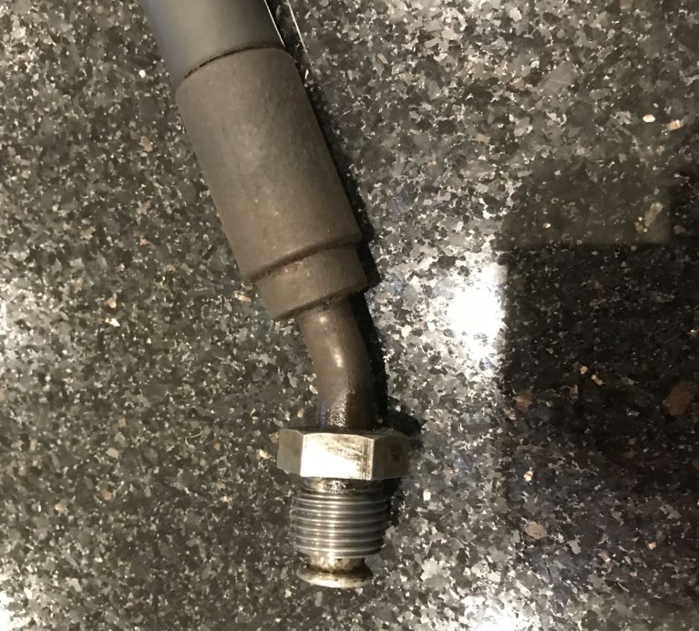

The end fittings are angled. One at 90 degrees at the steering box end (obvious) the other end at 30 degrees at the pump end - which I hadn’t noticed. They couldn’t source the 30-degree fitting, so the new pipe is being made about an inch longer than the old one to give a bit of wriggle room when it comes to be fitted.

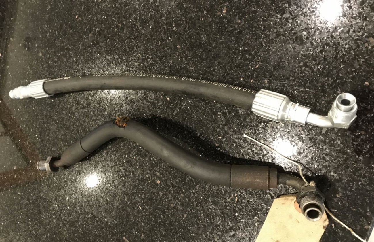

Update: I've finally received the newly-made hose.
Pictures below.
The old burst hose and the slightly longer new hose alongside each other. The angled fitting of the pump end of the original hose.
Pictures below.
