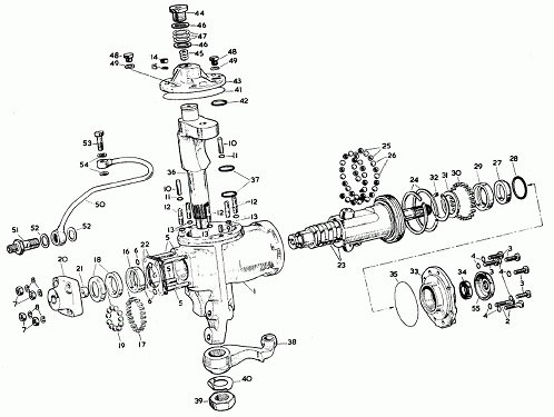

my mechanic changed the front seal of my 1965 3.8s steering box which worked fine but leaked, upon refilling it and starting it now turns left!
he's bled it, flushed it, cleaned it - still goes left!
help please from anyone that's had this issue and knows the fix.

I suspect that the box is not at the straight ahead position when the wheels are, if the box is not centred, then the assistance valve is opened. Just try turning to the right until there is a 'dead' spot, i.e. no pull?

Thanks but my mechanic tried that it seems that the power is sending it right all the time.
I'm getting depressed speaking to many steering specialists who say all say the Burman box (which confusingly has Hale on the casing) is nothing but trouble and there's probably a balance problem.
The best advice is change it for a rack and pinion replacement which cost £2k + ouch!!!
My mechanic is reluctantly looking at pulling the box apart, I meanwhile continue to ring around
Anyone with a rescue plan would be welcome

Not sure exactly which seal he 'fixed' but he must have moved the valve that opens and closes the portsto create oil going to one side of the piston when in the staright ahead position. Perhaps sealing sleaves were damaged etc etc. I would suggest a specialist looks at it. If you search for Burman power sterring specialists many come up but perhaps readers may have used one and recommend them. Be careful of using racks unless from a known expert as they can change the steering geometry.

I have exhausted contacting all the steering box specialists up and down the country, every one says the power Burman box is trouble and they wont touch them with a barge pole! so I am left with scrapping the car or fitting an expensive rack system - which I have decided to do.

18 years ago due to back and shoulder pains I was advised to replace the standard manual steering box with a 420 front subframe with the later Marples (cast iron) power steering box powered by an XJ6 pump (extra fan belt drive).
I was advised not to dismantle it but live with the leaks, I couldn't so removed the spindle but ensured that the torsion bar in the input spindle was not moved (this can result in your problem of steering pulling to one side). I always left the belt a bit slack so as not to lift the relief valve, unfortunately I forgot this and when replacing the engine recently I tightened the belt and blew the in the steering box end cover seal, but still managed to drive 150 miles home.
I doubt there is much chance of getting a 420 subframe, but the power steering box still give very good handling with 1 degree of negative camber.
