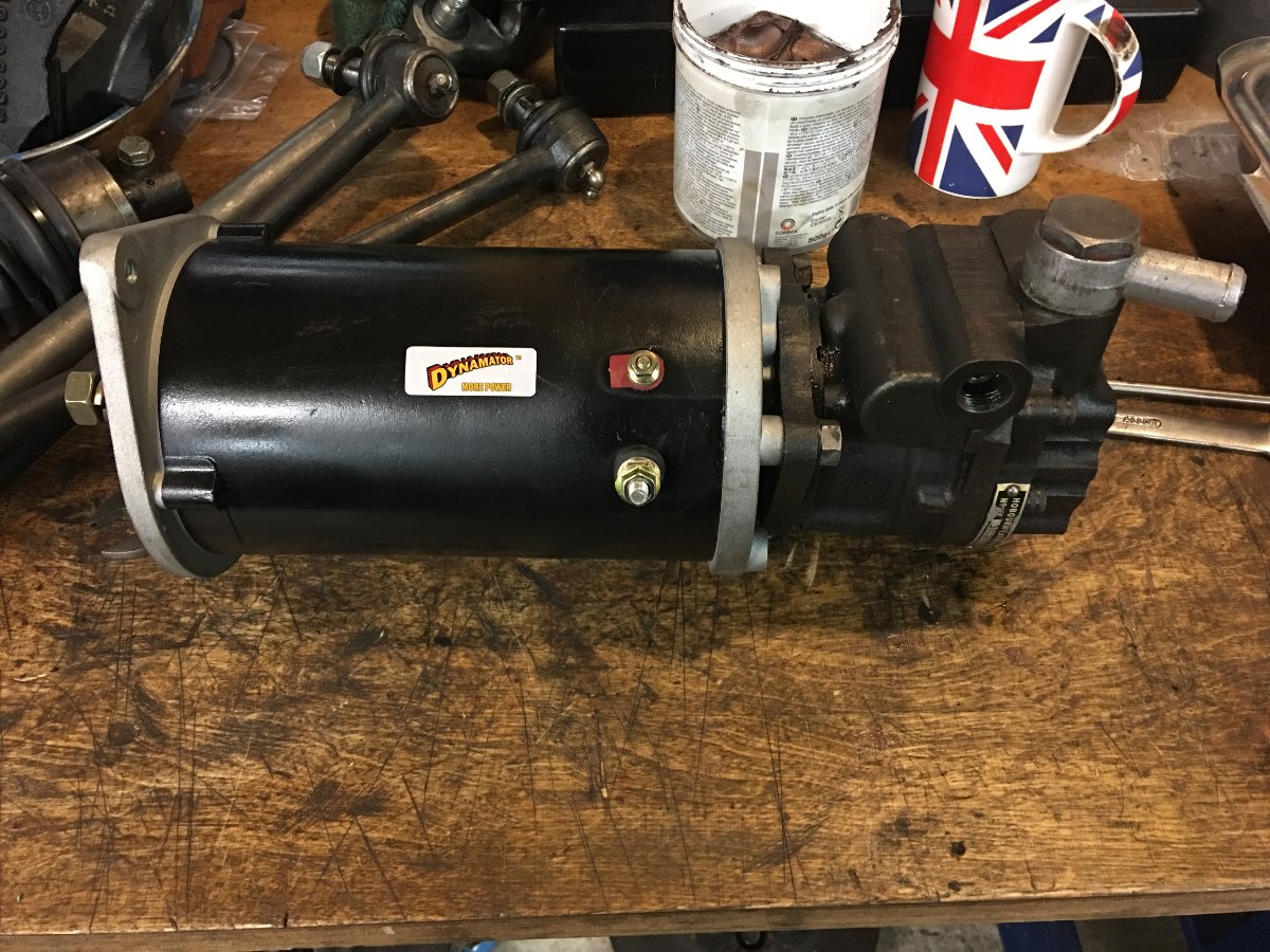

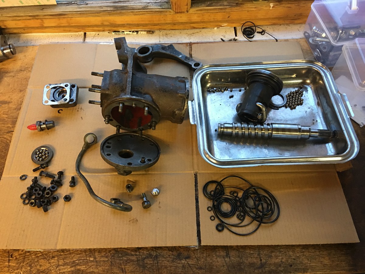

I was so unhappy with the rack and pinion I had fitted to my 3.4 Auto about 14 years ago, I have been working to return the car to the original system. I swapped to a rack, as I could not stop the hydraulic oil leaks and back then (in Holland) could not seem to find replacement steering boxes or other solutions to fix the leaks. The rack and pinion never felt right, and the turning circle was greatly reduced - maybe it was badly done?
I rebuilt the PAS box using a cheap set of seals, and it was not that tough once I had worked out that there are two types of Burman PAS box with different numbers of balls. I had to buy a vernier caliper to measure the balls, but a man can never have enough tools. I am not surprised it was leaking given how hard and flat the old seals were. I used the old tie rod and track rods with new bushings on the end of the tie rod. I mounted the pump on the end of a Dynamator - this is a C42 look-alike rather than the C-48 dynamo I had originally, but it looks good in there.

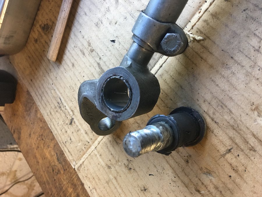

2. The new bushings on the end of the tie rod (e-bay), were a devil to push in and did not last until I got to the MOT station 3. The track rods were pretty lose, so I have gone for new ones, unfortunately I cannot find original solid one, so have had to go for adjustable one which just don't look right.
A rather long intro, but what is so wrong with the original setup, maybe the focus should be on ensuring a good supply of refurbished PAS boxes, and components and a reasonable price. I have been quoted over 2000 GBP for a refurbished Burman box, when the seal set cost 30 GBP?
