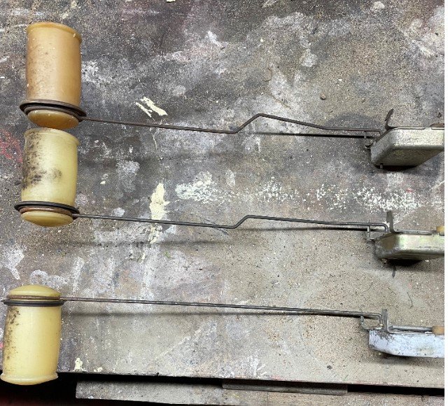

Also, I’m looking at the spare sender units I have and although they have different part numbers in the catalogue for the LH & RH, C26212 and C26211, they seem identical except the floats are on different sides.
The floats seem to be interchangeable in that they unclip and can be reversed.

A bit of digging and a closer inspection shows there is a subtle difference between the LH and RH units. The connection arm of the LH one appears to be shaped to give it an off-set whereas the RH is straight.
Still, if anyone has any further or better info, it’d be most welcome.
Cheers, Mac.

With no info available, I decided to do some testing.
Using a spare LH tank I have, I loosely fitted a LH float and then, to make sure it wasn’t fouling inside, I slowly turned the tank upside down and listened to the float move under gravity. It was fine.
I then repeated the exercise using a RH float, the one with a ‘straight’ arm and that too moved freely without fouling.
I also tested each of the spare sender units I have with a multi-meter, the readings on each of them were different but the resistance range from ‘full’ to ‘empty’ would appear to be around 20 - 200 Ohms.
I cleaned and re-assembled the lot, half-filled the tank and got a ‘half full’ reading on the gauge, so it all appears to be working fine now.
I’m still no wiser as to why the arms are different.
Mac.
