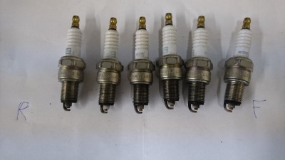

Re: Lack of power, hesitaiton, lean running problem
Also attached is a pic of the plugs after 10 mile drive this morning.
