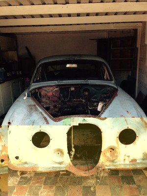

Can I ask WHY you are removing the hinges? by undoing the bolts into the door (easier) you can remove the door and leave the hinge in place, I did (don't lose the shims).
Your shell at the front looks very good, the lower 2" of ours was missing, also the lower half of the sills. Depends how solid it is it may not be too bad, more steel to replace means more time and cost.
From that picture its not a scrapper.
Brian
