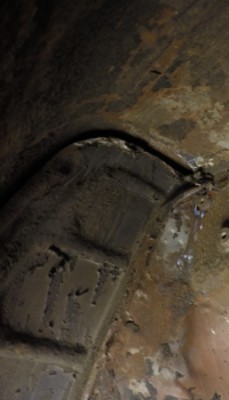

I may have missed something, but are you talking about the closing panel, see pics ?
They tend to rust at the bottom where they meet to bottom edge of the wing, you will see the holes that were in mine if you look in the shadows in the second picture.
Jon
