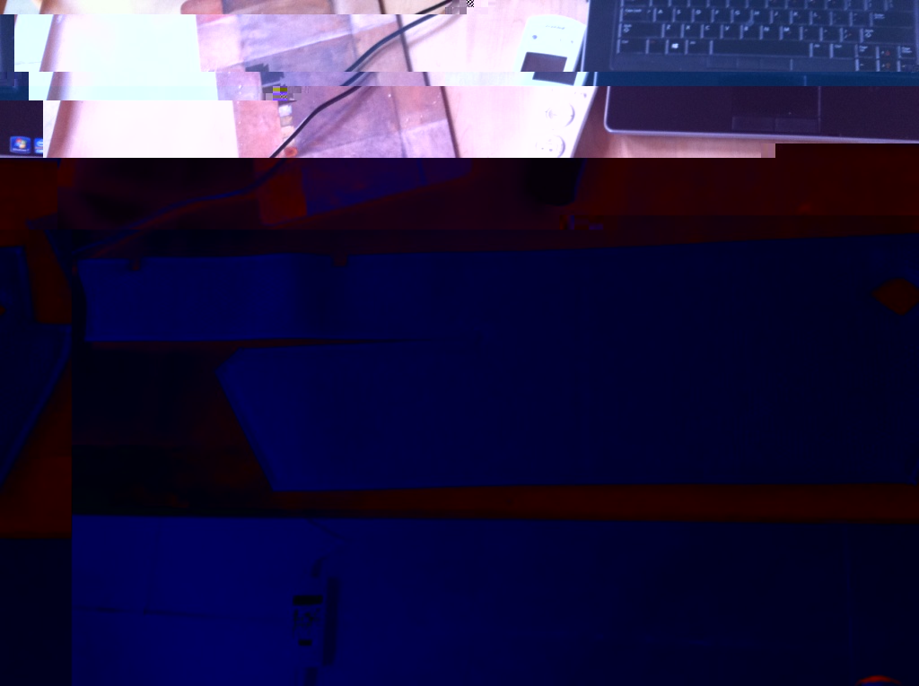

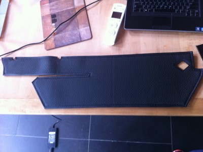

Hello I have a 1968, 340. I pulled the engine and gearbox yesterday to replace the rear crank seal and complete a few other jobs. One you the jobs was to install the sound proofing kit/ insulation that I purchased from SNG Barratt.
Have managed to work out where most of the sound proofing goes but there is one piece and I have no idea. Also there are two metal strips that rivet somewhere again I have no idea. Have attached two pictures of the mystery pieces. Hopefully some one will know where they should be fitted.

Mystery solved the insulation wraps around the air blower/ heater box still don’t know where the two metal strips go.
