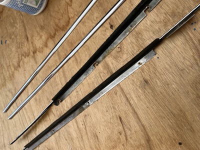

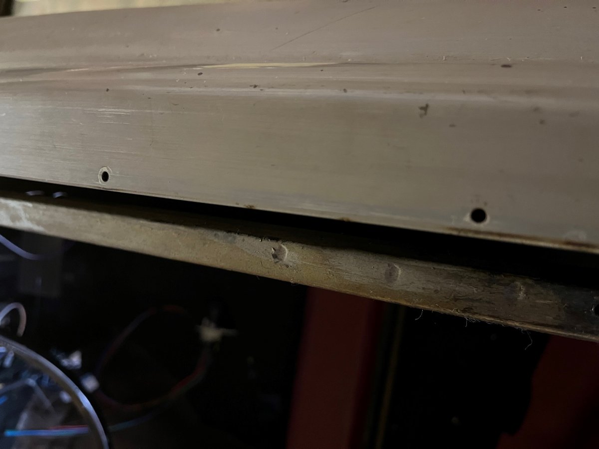

Hi all again, I am currently rebuilding a 1965 Daimler V8 having previously rebuilt a 1968 Mk2 240. I am at the stage where she is ready for painting and am now preparing EVERYTHING before she goes so that when she comes back I can progress with building rather than parts searching. The Daimler was an unfinished project I bought, from JEC Classifieds, and I thought I was missing the chrome window weather seals which were fitted to the 240. I have straight chrome strips that fit on the top of the doors and the doors have 7 holes along the top which would seam to mean that just a chrome strip is located there. I have bought replacement weather strips, like fitted to the 240, and can weld up the holes and fit them but I am struggling to understand what channels the rain water if the car is just fitted with door top chrome strips as I do not have any other type of external rubber strip. I have attached some pictures which show the different strips and the appropriate holes. Any clarification appreciated. Tony D

Mike, thank you for your reply and information. Combined with more research I have found out that the chrome beads BD17091-2-3-4 were fitted to earlier cars, although I do not know exactly when they changed, and the upgraded beading incorporating the window rubber seal, BD25962-3-4-5 were fitted to later models, hence why I had them on the 240. Assuming I can source replacement rubber seals I will weld up the holes and fit the upgraded fittings. However that still leaves the question ( for a friend who is also rebuilding an early Mk2 and has the same problem) of what happens to rain water on the earlier models with the chrome decorative strip. Was it just allowed to just run down inside the doors ? There is an inner window guide but is there nothing on the outside, if a second window guide should be fitted externally, there are no holes in my doors for them to mount. I have a solution now, hopefully, but still do not understand the earlier design. Any clarification once again appreciated. Tony D

Tony,
the chrome strips are pure cosmetic, what is intended to minimise the rain water arethe felt strips which the glass runs against. As the doors have drains at the bottom and are lined with plastic sheet (To keep moisture away from the door cards), Jaguar clearly expected some water to get inside the doors.

Alec, thank you for the clarification which can close this thread debate. It appears that jaguar came up with a better solution on the later models, which I hope to use, if I can source the new rubbers to fit the channels. Tony D

Postby alec2824 » Tue Aug 29, 2023 10:40 pm
My '63 Daimler had the brush type "seals" that allows plenty of rainwater into the door, which then passes out of the door via the drain holes. I modified mine by adding a separate rubber "up the window" seal to the outside. This entailed removing the window glass and drilling four holes into the door waist frame and then pop rivetting the rubbers in place. Alec G.
